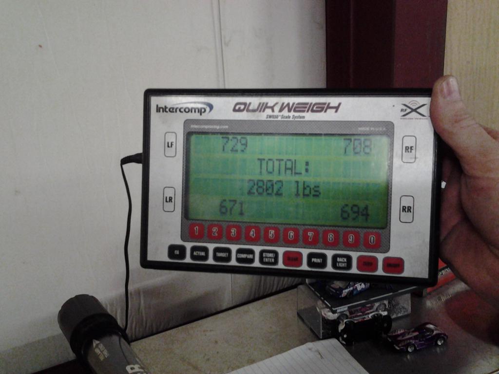

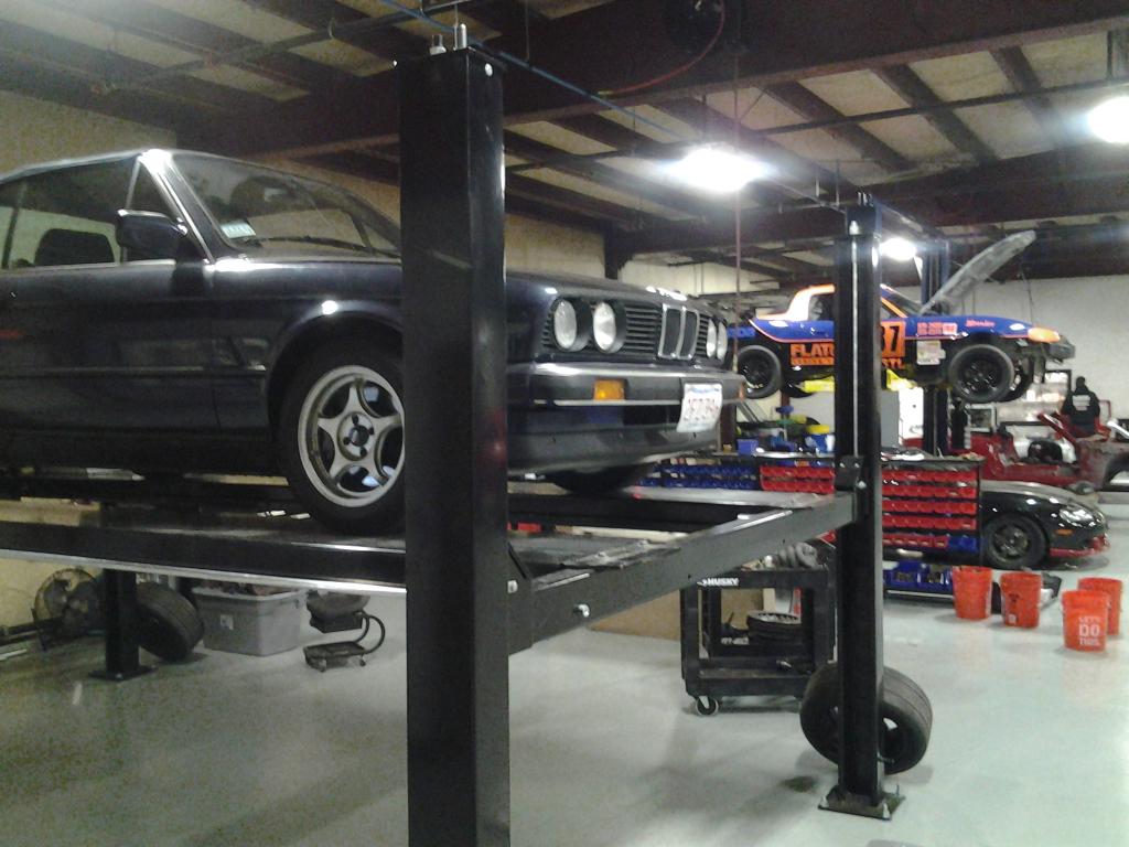

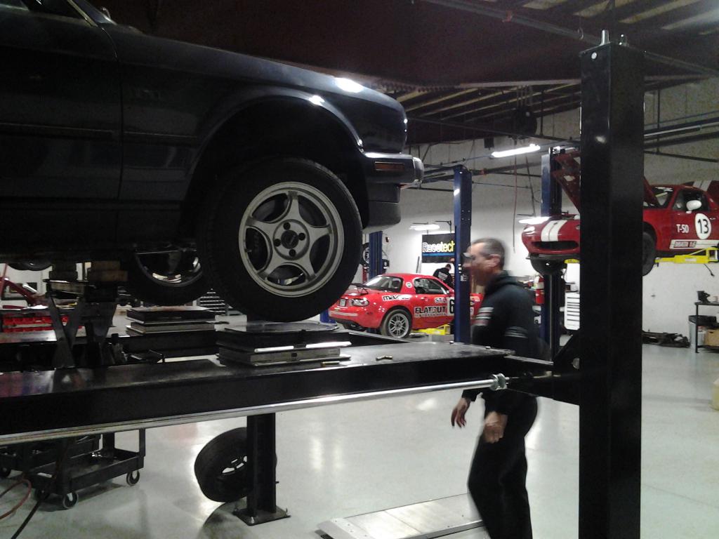

Got my car corner weighed at Flat Out Motorsports in Mendon, MA. They are primarily Mazda guys but they did have an E30 M3 track car in the shop as well. I had the car weighed with about half a tank of fuel (my gauge is kind of wonky), spare tire and jack, Luke box, full interior, and X brace. Not too bad considering a stock 89 vert is something like 3015 lbs.
On the scalesLast edited by Bearmw; 02-02-2016, 02:04 PM.Never argue with stupid people, they will drag you down to their level and beat you with experience. -Mark TwainComment
I ended up lightening a lot of small stuff such as the engine compartment cowl cover and carpeting (I removed the heavy under padding). I also have a lighter exhaust, brakes, hood, etc. I could probably get it down by about 100 more pounds without cutting any sheet metal by deleting the Lukebox, power steering, ABS, and so on but I like having these things.
I was happily surprised by what it weighed and by the balance. Nick at Flat Out Motorsport said it was really good. This is with regular M3 springs and KYB struts so I have no adjustability there.Never argue with stupid people, they will drag you down to their level and beat you with experience. -Mark TwainComment
