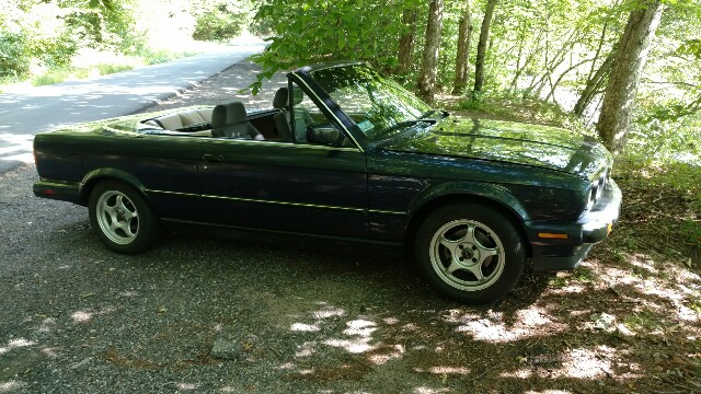

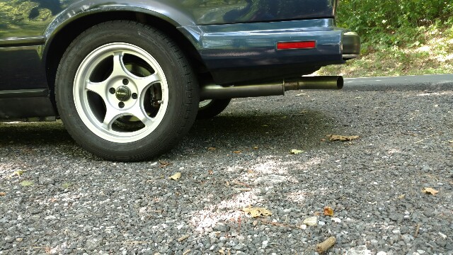

    Out today enjoying the scenery. I'm glad I'm not stanced because I easily straddled a porcupine carcass on a forest road that would have got caught up on a low car.
    My new muffler too.

      A glamour shot.

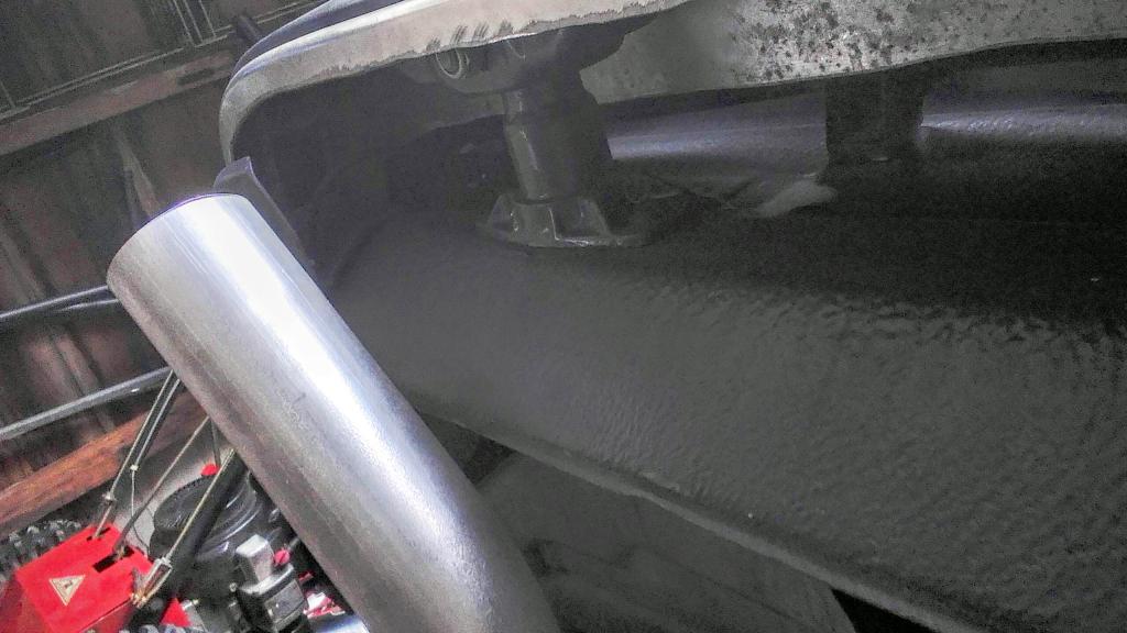

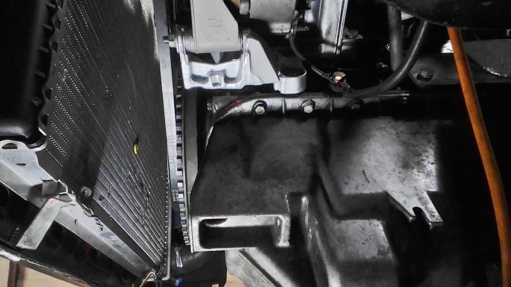

        Here is a pic showing my obsession with keeping weight down. I also cut the brackets to remove the shock portion and then welded them solid. The same was done on the front. Foolish maybe but I like how the car handles. Hopefully I don't find myself in a situation where the 5mph bumpers are really needed but in any case I assume the risk.

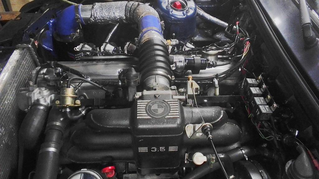

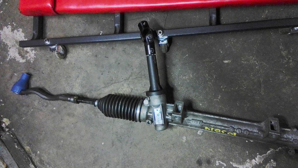

              I decided to make some more changes including a manual Z4 rack.
              Never argue with stupid people, they will drag you down to their level and beat you with experience. -Mark Twain

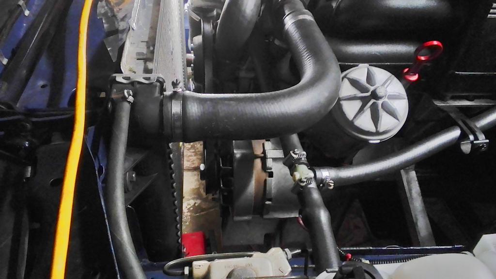

                And I wanted to use a smaller and bit lighter alternator so I modified the b35 bracket.

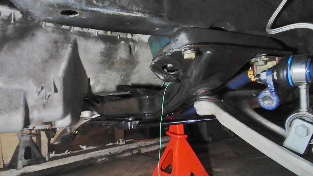

                  I also decided to try factory style sway bar links for the IE 25 mm hollow bar due to the noise from the rod ends. The rod ends make noise and I found it annoying on a street car. Hopefully the Meyle HD links hold up in this application.

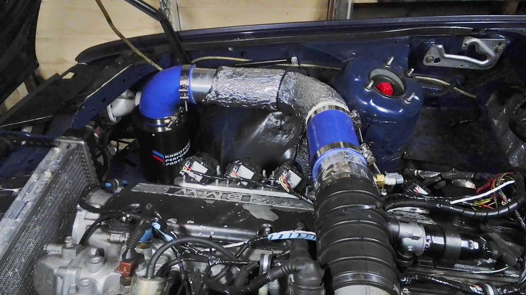

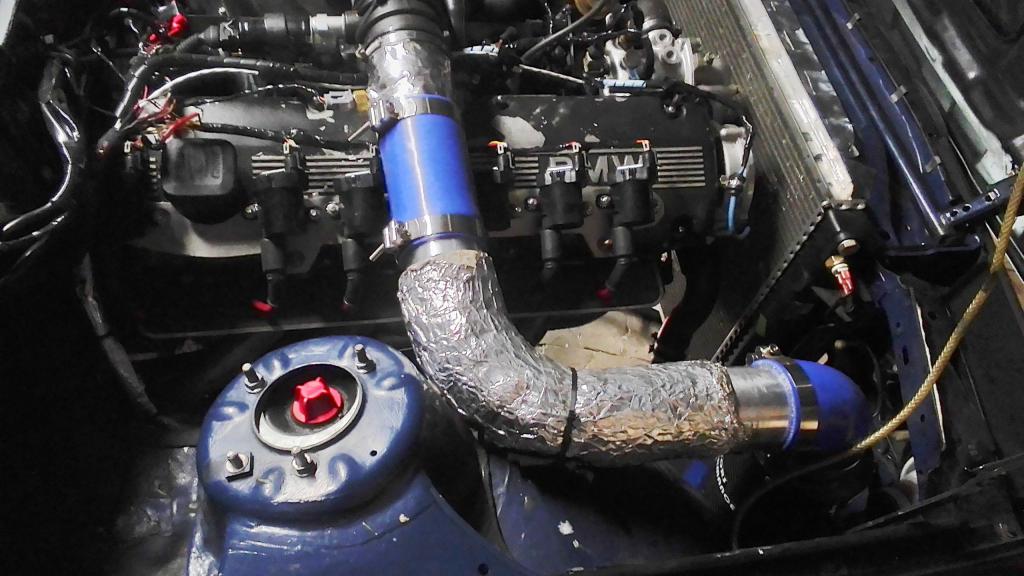

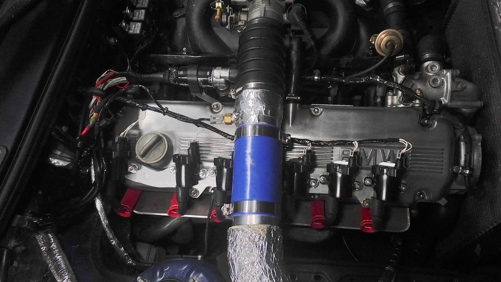

                    My last change (for now) was to try a different cold air intake setup. I like the look and light weight of this one.

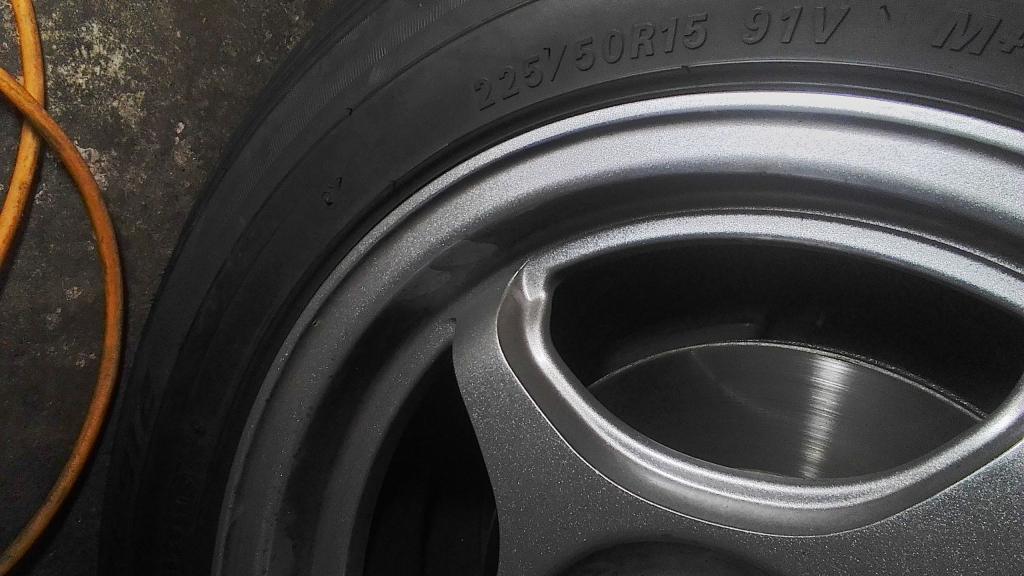

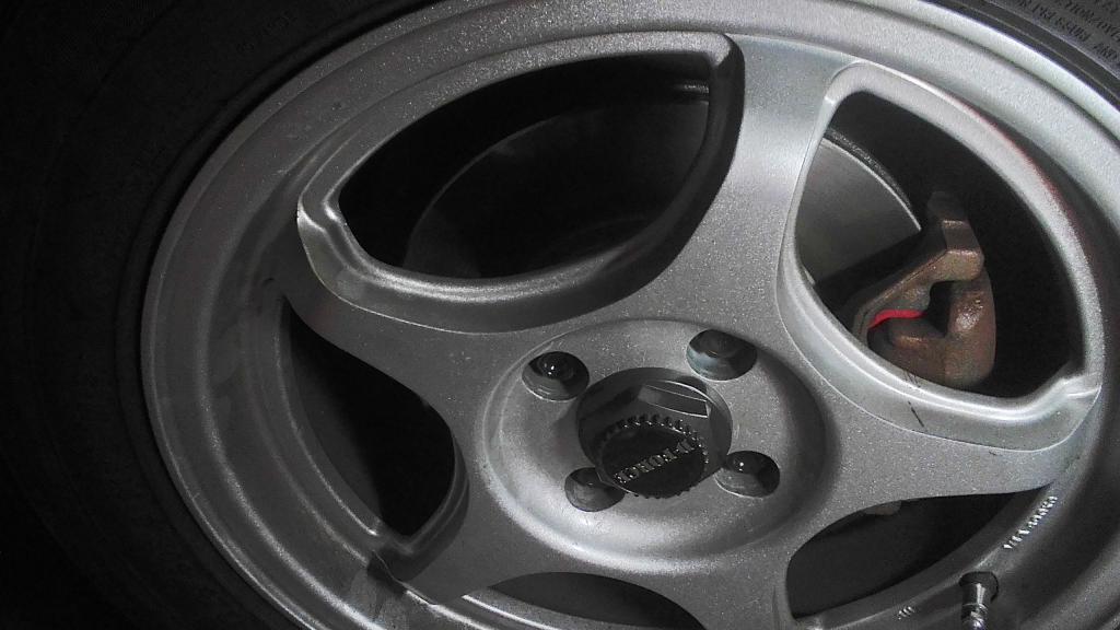

                          I went back to stock brakes with Pagid red pads because although the UUCs stopped well they would squeal unless hot which became annoying as people in other cars would always hear it and well it ain't a race car.

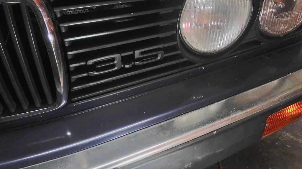

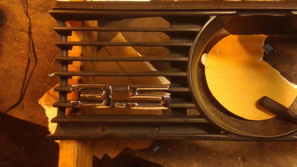

                            A friend of mine asked me if I thought the emblem was "big enough"? I also thought it stood out too much when it was chrome so I painted it with some flat black stove paint I had laying around. I think it looks way better this way. Much more subtle.
