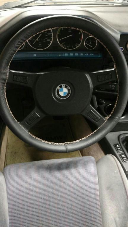

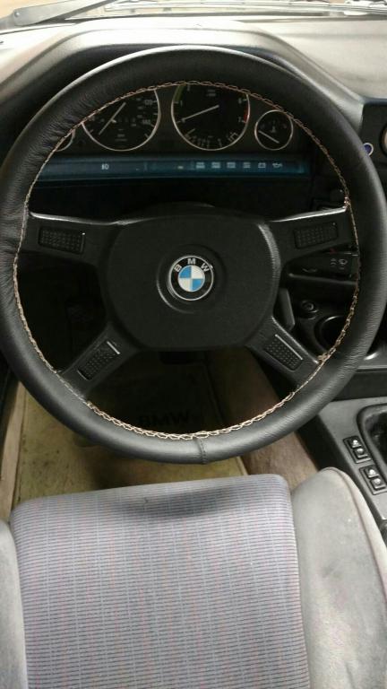

              Since I lowered my steering column a little I have never liked the factory 3 spoke wheels all that much with where my hand position is so I went with a basic 4 spoke wheel that I covered with a nice leather wrap. It is still not a fat diameter but is much more to my liking than the Mtech or Sport wheels I had before. If I want to get fancy I could change out the center emblem for say a factory Motorsport emblem but those cost more money so I will keep it looking like this for now.

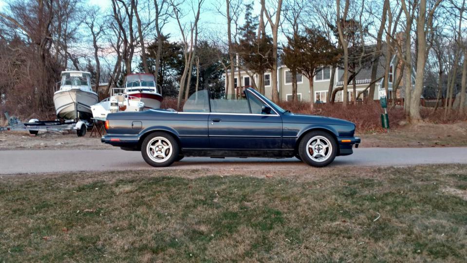

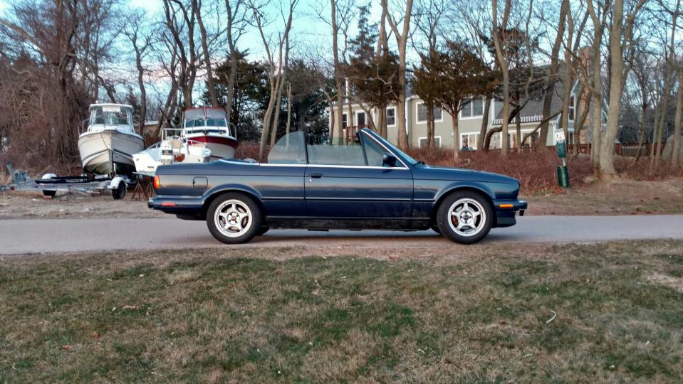

                I'm am happy with the current stance and as you can see I prefer function over form. I may experiment with the rear sway bar setting and maybe change up the tires or even a little bit less front camber Overall the ride and handling is very good.

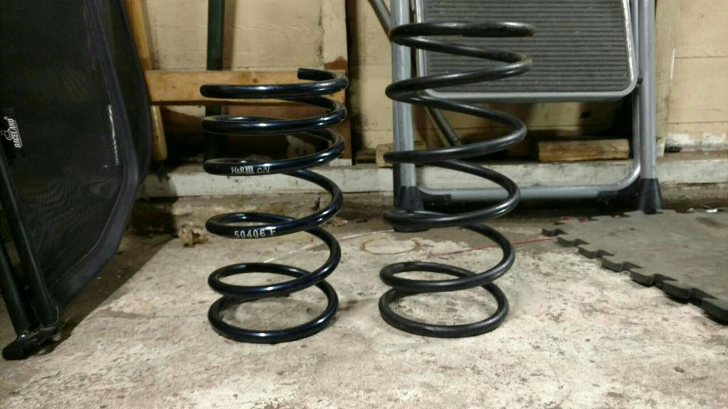

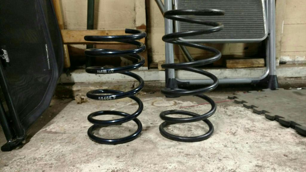

                  The difference between the H&R sports and the M3's. I am still running M3 springs in the rear.

                    Looks a good height for a daily drive!
                    I've got Eibachs in the front of mine, and stock m-techs in the rear for a little more height since I tow with my car sometimes.

                      Yeah man. I sometimes have four people in the car and bottoming out SUCKS. I'm also trying to avoid the cracked pan badge of honor.

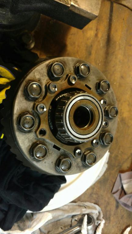

                            I have been working on a diff change. I am going to try a 3.73 to replace the 3.46 ( I may end up putting it back in) . I got a good deal on some new clutch discs so I added those while I had it out of the car. I just went with the 2 disc 25% lock. Other than that and replacing most of the seals it is going in as is because the bearings look and sound pretty good and if you haven't guessed I am cheap.
                            I hope the 3:73 isn't ridiculously short, especially with the new 205 tires. I plan on driving easy(ish) for the first 500 or so miles to break in the tires and the lsd. I thought about a 3.64 Torsen type but the one I saw was too much money.
                            I learned a few things doing the clutches. One is that it is super easy to strip the 8 Allen head bolts. I was lucky I didn't. Another is that there is a sequence for removing them and installing them and that it makes sense to replace one at a time to keep the plate flat and level. I also used red loctite on the bolts.

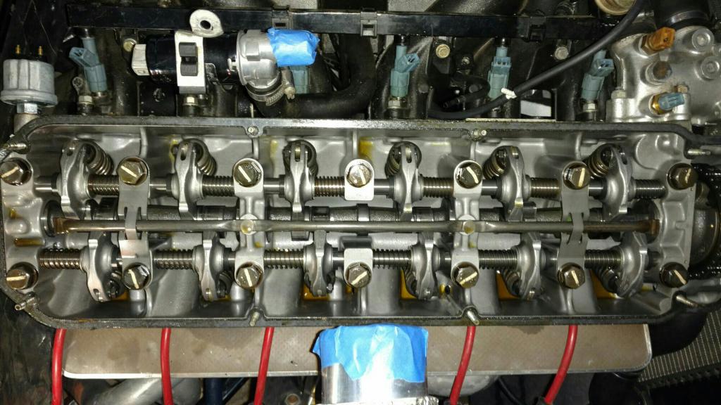

                              Here is a random pic showing that the valve train is still minty fresh.
