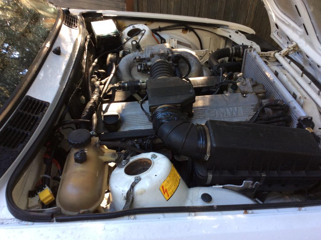

I put the expansion tank where the battery used to be after relocating battery to the trunk. I’m not sure that’s a good idea having it close to all that electrical stuff, but we shall see. Also, for exhaust I used most of a 97 328i system including the cat and it sounds awful. Got to work on that.
m30 motor too far forward with Garagistic mounts
Just popping back in to say I’m having the same issues as you with these mounts. I ended up putting a stack of washers on the left side mount and grinding the hell out of my Intake manifold though. With all that I have around a 1/8” between them now. It’s also a really tight fit at the front with around 1/4” clearance or less between the distributor and radiator. Haven’t decided if I want to slot the mounts/redrill to go further back. My advice is to stay away from these m30 mounts until garagistic gets them a little more dialed in. I wish I would Have known good n tight was still making his before I bought these but oh well.

Yikes. It's almost like the engine is not tilted over enough. I can remove my intake manifold no problem.
From your pictures it looks like your top transmission bolt is in the trans tunnel. Mine ended up above the tunnel and required a little more clearancing, I left that bolt out.
