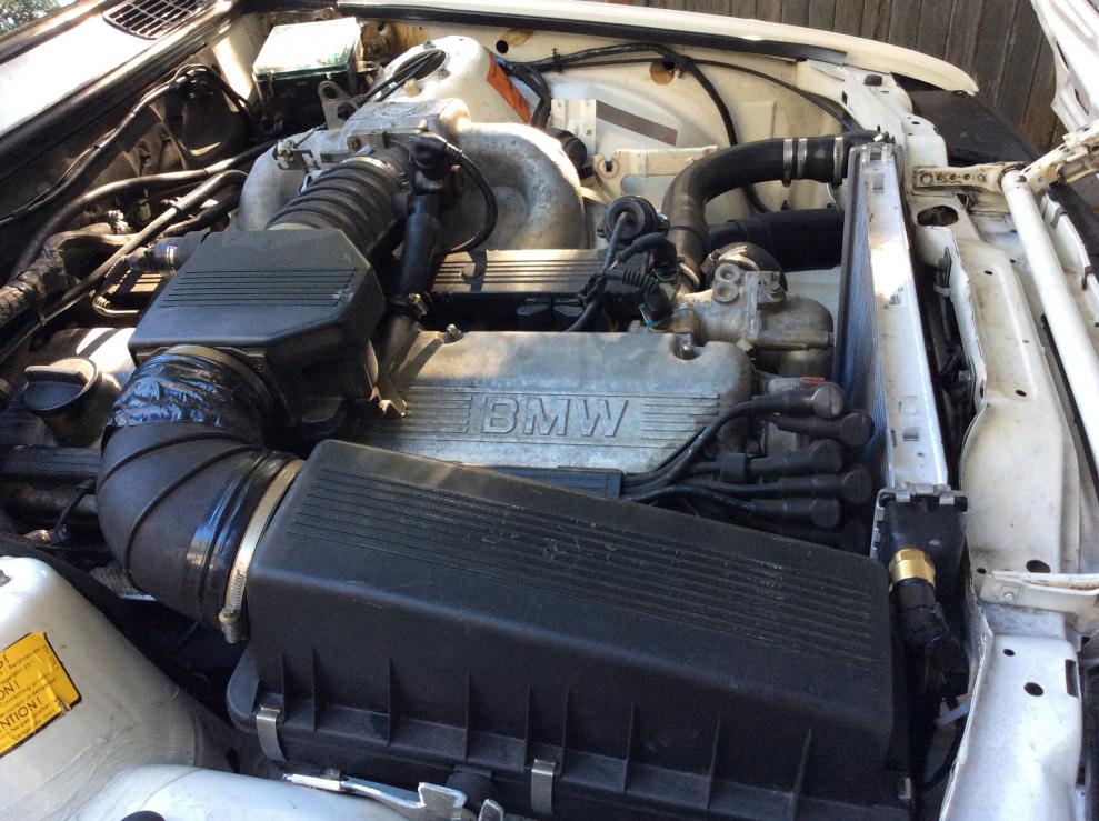

                              Finally got it on the road again. I have been working out some little stuff, but at least the motor now seems to be in the right position in the bay. I have the g240 with a stage 2 clutch, the clutch action is a bit chattery but not terrible. The power is fine, probably similar to my e36 m3. My 5.0 e30 definitely feels quicker, probably because of the 300 torques.
                              • Stvstr
                                • Dec 2013
                                • 82
                                Engine bay and distributor relative to radiator. Pretty tight. A 5.0 fits a lot easier until you deal with the driver side exhaust and boosterless brakes.
