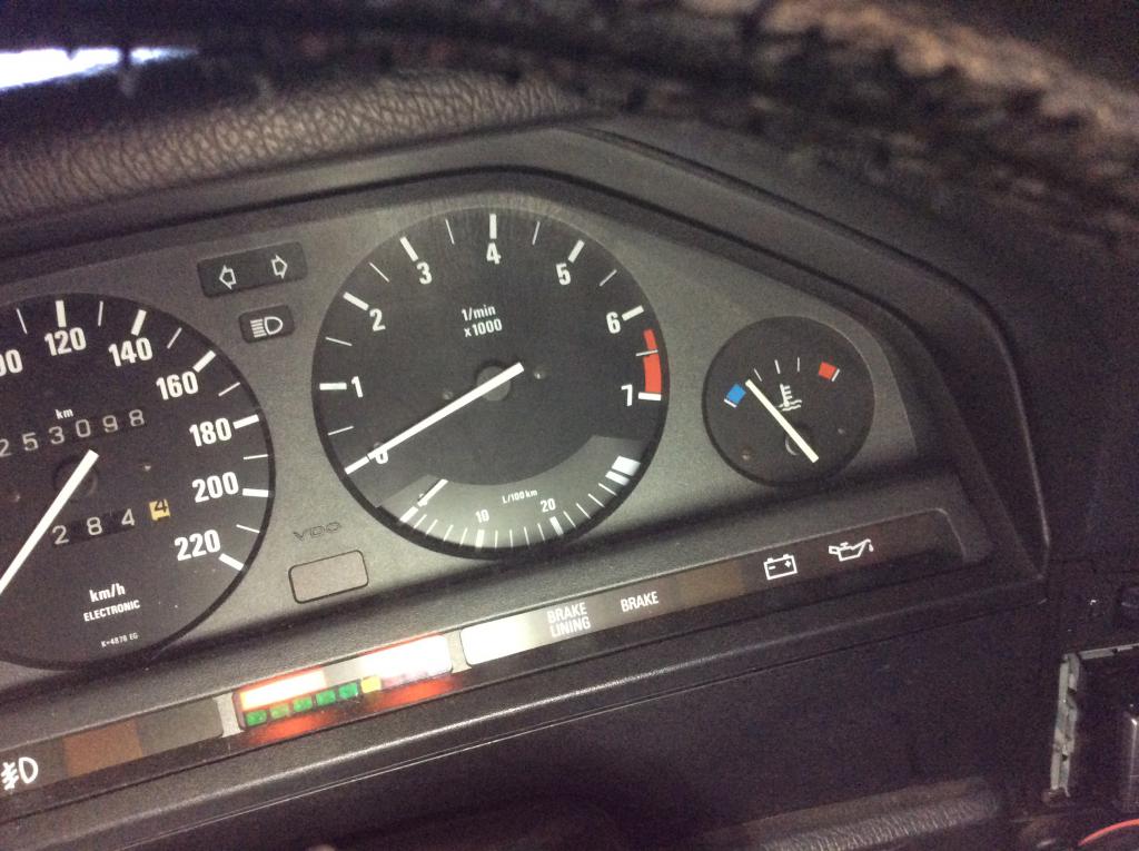

            On a completely different note, I have been driving the m30 e30 for a while and the temp gauge always stays midway in the blue zone. If I let it idle it will creep to the top of the blue. I have a new 176 degree thermostat and an e28 535 rad. Anyone else seeing lower than expected engine temps?
            • Bearmw
              • 1323
              #51
              I am also running an 176 tstat but the needle is usually a tick above 1/4 and can go as high as just over 1/2 before the fan kicks on.
