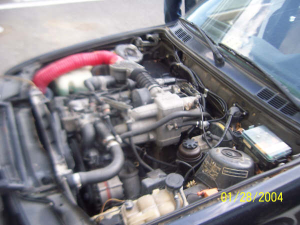

I got here home just about 2 hours ago. Most of the electronics work but the motor won't turn over. The trucker got a new battery, he said it worked and when he got it on the trailor is quit after a few feet (thanks God it was on the trailor).
Can anyone tell me what this motor would be out of? I want to get a bently and start getting gaskets and stuff for it. It looks different to many of yours. Can you see anything wrong by just looking at the pic?
Intake has been removed already so no flaming haha
ThanksComment
ahh a gen 2 motor, e28 535 or e24 6 motor...could be more like the older 735's but i duno...e28 or e34 is the bently you needM stands for Money:hitler:Comment

thanks for the help.
Since I have a gen 2 motor, does this make anything harder or easier? Broad question but if its the same as all the others I will be able to follow most of the steps about the M30 on the board.
That link is basically telling me that I have the weakling of the bunch. I guess I will have to turbo the thing down the road (way down the road)Comment
