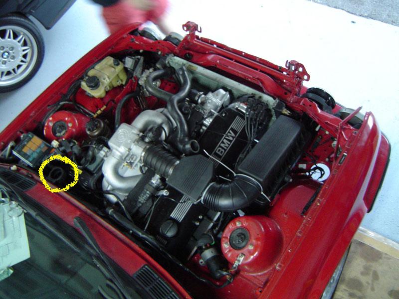

      One other thing. I circled in yellow a piece that I want to get out. I dont' want to force. It almost looks like 2 pieces but I want to make sure. Do I need to take the bracket off to get it off the car or can I take the top or bottom off? One of the piece goes into the fuse box and I really don't want to take the fuse box out.
      Does it screw off? Almost felt that way. I just don't want to force anything.

        Ahhh...the C101 conector.
        It's basically 3 parts, the part that attaches to the firewall is like a strap, look for a protruding part of plastic and un-snap. It wraps around the connector like a belt.
        Now the connector top and bottom should be free - they separate by twisting the ring - and it come apart.
