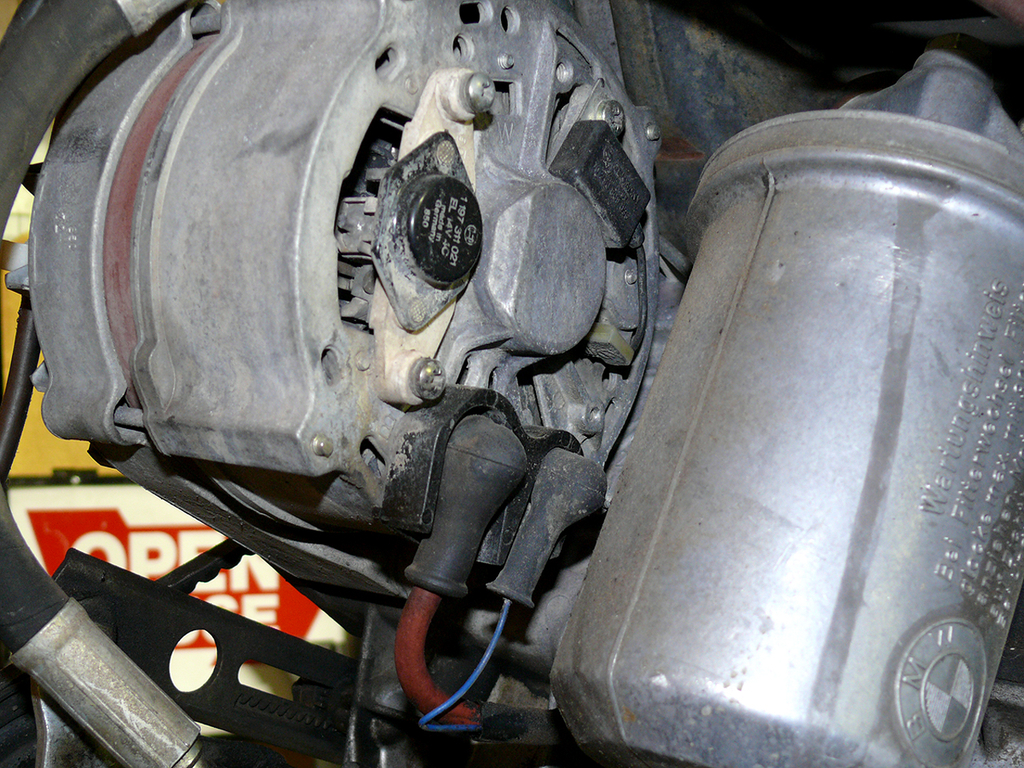

What do you think is up with this?

        One is power from the starter I believe, and the other is the B+ or D+ or whatever it's called.

          Where does that little blue one end up?
            That is the alternator excite wire, it remains blue all the way up to the c101, (battery light on the gauge cluster) just wire to the blue wire on your chassis harness.
            the other thick red wire goes to battery however it is easier to run it directly to the back of the starter.

              So it does nothing for charging?

                Actually, the dash bulb completes the circuit, so if it's out or that blue wire isn't connected, it won't be doing any charging.

                  oh, looks like I should hook that up then, lol.
                    The motor will run without it but the battery wont charge, thats all.
