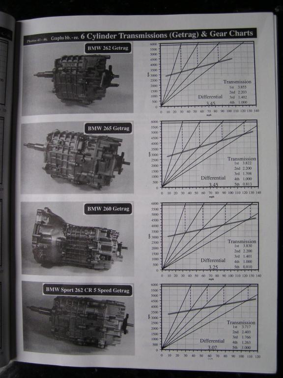

                          OK since we're on the subject, I thought I'd ask..
                          I have been hearing all these different transmission names being thrown around. I know the g280 came from the ///M series cars, but the others are all confusing. g260, 260/5, 260/6, 265. There's no thread that explains each of these transmissions, what car they came out of, what the numbers indicate, or the differences in gear ratios.
                          And what do the /5 and /6 mean?

                            The Getrag 260/5 came in the earlier 3.2 liter powered cars. 533i, 633CSi, and even some 733i I believe. I don't have ratios handy but the 260/5 has a reputation for not being as robust as the 260/6 and the 265, and sometimes makes some bearing noise upon shutting the car off that is known as the "265/5 rattle".
                            The 260/6 replaced the 260/6 and is regarded as a very robust transmission. They were used in pretty much anything that got an M30 built in and after 1985. The gearchange is generally agreed to be a bit smoother than the 265.
                            The 265 is the most robust family of transmissions available for the M30. The 265 actually comes in a 262 case (262 was a 4 speed box) but they have 5 speed guts. The 265s can be notchy sometimes, especially into 2nd gear (personal experience) but tend to last FORVER and can take tons of power and torque without exploding. The 265s were offered in the 3.5 liter 635CSi and E23 735i (europe) up to at least 1984, as well as some E28s. It seems that BMW used them here and there until around 1986 but thats not a definite cutoff. The 265 has a close ratio version with a dogleg patten that is very sought after and rare.
                            The 260/5 is a one piece case with an integrated bellhousing and a "checkerboard" pattern on the actual transmission portion of the case. The 260/6 is also a one piece case but it has longitudinal casting lines that look like cooling fins. The 265 is a multi-piece case with a removable bellhousing, so telling the three apart is generally pretty easy.

                              Ian,
                              Great info, in my searches I also found this doc, perhaps its helpful. Not sure if these are Metric Mechanic specific ratios or stock or its the same thing.
                              ZM
