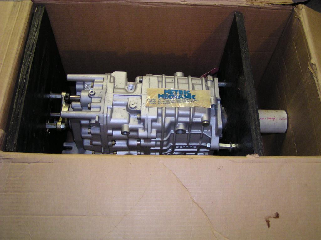

        Here is my trans, dont even know which one it is yet, came with the engine. I need to take out of the box and look for numbers so I know what I have.

              Originally posted by ZM Blue Devil
              If anyone wants the original pic, pm me your email and Ill send it, you can see the numbers and the graph better.
              looks like a 265 out of an M3...?
                Or 262 behind M30 (used for example in E12, E28 etc etc). Quite rare, though.
                I had one of those in my 335, with 3.64 diff had 4000rpm @ 100km/h, so that'll be one "problem". E34 525td has 2.65 LSD which is "bolt on" to E30 by swapping the rear panel ;)
                  The diff the set up came with is a sideloader, the engine is the m30 from 79 3.5 so the trans may quite well be the 262. I will check tonight when I get home tonight. I assume there is some sort of a code/number on it?

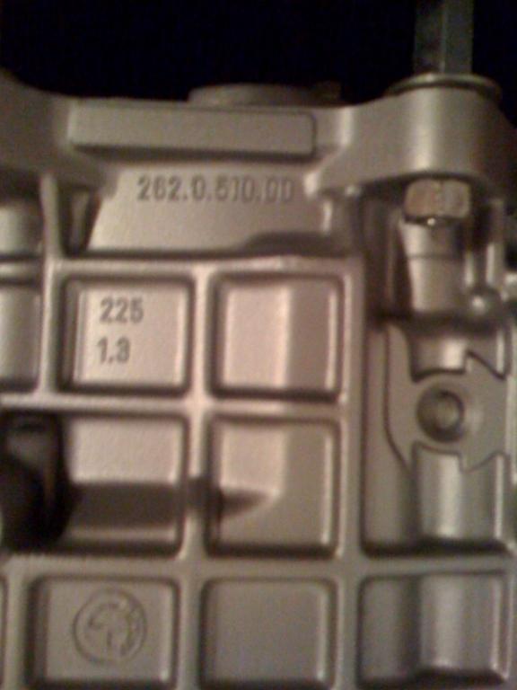

                    not the jack this thread but...
                    Got home today and took the trans out of the box.
                    its confirmed, 262 5 speed dog leg:D

                      Sweeeeeeet, same part number as the box in my 6er. You will enjoy that!
                        I have the same gear box also with the same part # but I don't think it's the dogleg. What year is stamped on the front of the tranny?
