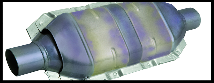

    Cat clogged after 1500 miles.
    My rarely driven E30 started going into a limp mode, no warnings, just lack of power out of no where. Brought to dealership and they found cat was clogged after back pressure test and checking temps of exhaust after it gets hot. Since ownership I have had to change the cat 3 times due to SMOG failures by visual inspection (serial number scrape * low car problems.) Now considering I have barely put any miles and there are no signs of major impact to the cat/resonator/muffler. Is there anythnig in the engine that I should check to ensure I am not contaminating the new custom exhaust set up when I get it fabricated soon?
