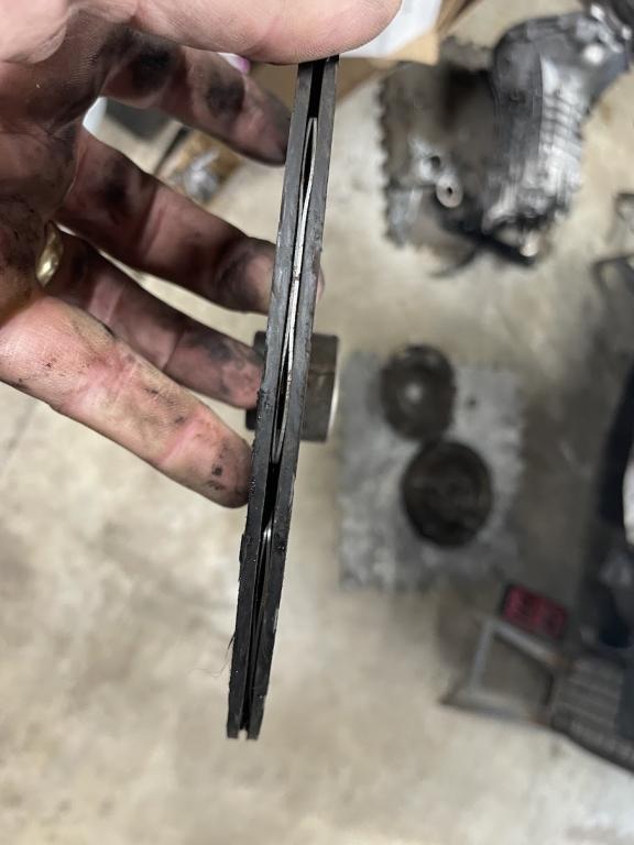

    Q1 - I have a dual mass flywheel, correct? 99% sure but wanted to check.
    Click image for larger version  Name:	LAzh9KcsmeH7cViSQXH4BDBhuB8wAmdRDffS9rPykdpThuehRPJfu57fw6Ff4rOV_yBEzfTyVWoKfrWJb5YkU0BJXNtrDZ2gh5TjJykPtAADdXAiZhOSc9YP7jdjZATbv2T91VJQrQ=w2400.jpg Views:	0 Size:	59.7 KB ID:	10064426
    Click image for larger version  Name:	OfolDsTfdDyxNJ9ibciC71of5Y8lD5TVH25nnzkq_PF_AW7eVTrXwouIVvYpwGrFZamXubbIkJG-IVJThRIJy4URi1SrZt0rMHBNgvsUgmk25OH-_jQUitNDhd2wSdREHHqoc5QH4Q=w2400.jpg Views:	0 Size:	67.2 KB ID:	10064427
    Q2: Clutch looks ok, but not great. Agreed? Drives fine, doesn't shudder or make noises. "While I'm in there". I'll likely go with this: https://www.fcpeuro.com/products/bmw...-e36-k70010-01

    Yes, it's a dual mass flywheel. Why replace the main seal if it's not leaking? There is a point at which one starts to replace not broken stuff with new stuff and doing so only creates issues.
