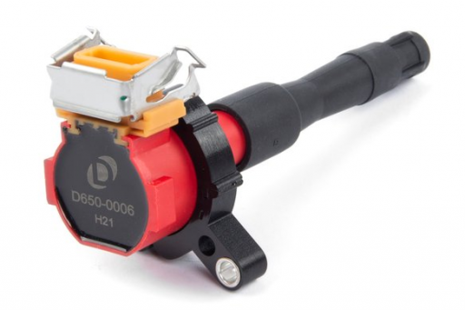

    Has anyone used these new'ish coilpacks from Dinan? I was getting ready to do a COP conversion and wanted to give these a go. They say they can be used on M52's, and I read those can also be used on M42's. Just wanted to doublecheck before purchasing.

  • bmwman91
    • Oct 2004
    • 3134
    They look about right, so yeah they are probably going to work. Just remember that you need to do a little trimming of the mounting eyelet for cylinder Home
    Transaction Feedback: LINK
    • MaCheFai
      • Sep 2022
      • 27
      Otherwise, it's a plug and play situation, right? Aside from the plate and hardware of course. I've seen some write ups where they're cutting into the ignition wires to remap them, and others where it plugs right into the coil pack. Just wanted to make sure it's the latter.
      • bmwman91
        • Oct 2004
        • 3134
        Yes, plug and play other than the mechanical hardware and trimming one of the eyelets.
        You can run the stock coil wiring over onto the valve cover without cutting anything. it is sort of messy since they wires are a bit too long, but it is not the end of the world. Just make sure to have a reasonable service loop for the cable length that spans the chassis to the engine so that you don't fatigue the copper conductors. Also make sure that the main body of the cable bundle is secured well on the engine side so that none of the connectors on the coils see excessive tension or vibration.
        • MaCheFai
          • Sep 2022
          • 27
          Thanks for the advice. Placing order. Will report back once done.

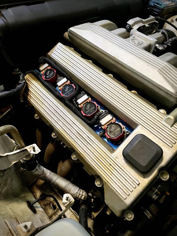

                • MaCheFai
                  • Sep 2022
                  • 27
                  Just finished my Coil on Plug conversion. Super easy and fun project to do with the kid. He seemed to learn a good amount in the process too, which is always a plus. Anyway, I think it turned out nice, clean, and most importantly, runs great. And with the addition of new NGK plugs, the scientific "butt dyno" can feel a slight increase in power in the lower range. And just seems more responsive overall. NI still need to grind off the brackets from the old coil pack on the side there to open it up a bit more.

                  • bmwman91
                    • Oct 2004
                    • 3134
                    Very clean setup, nice work!
