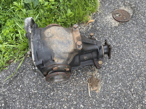

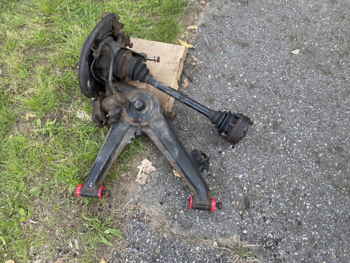

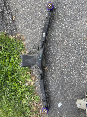

                    So after getting new wheels and tires on I noticed that the car felt super squirrely above 50MPH, and that the alignment was way off in the back (toe), and as a result, since I wanted to put the differential in anyway I decided to go all the way and swap the subframe with a fresh new unit, getting all new bushings in the process. The whole thing took way longer than expected, and I ended up cutting a hard line on one of the trailing arms, and the subframe support bolts got sheared on both sides, so I am still waiting on the replacement parts to come in, but at least the lion's share of work is done.
                    Status update:
                    *Engine - Unchanged (for now)
                    *Suspension - All new bushings installed, new rear subframe from a low mile CA car
                    *Brakes - Rear brakes completely replaced, front 280mm kit fully assembled, waiting to be installed
                    *Driveline - 4.10 LSD Differential installed
                    *Wheels + tires - Installed
                    After buttoning up the car I am planning on swapping the front brakes since I have to bleed the whole system anyway - I figured this is a good time to do that. Next few weeks I am planning on getting the wideband sensor and 30lb injectors into the engine with a modified fuel map. Stay tuned :)
                    • bmwman91
                      • Oct 2004
                      • 3134
                      Nice work! The rear subframe can definitely be a hassle if it has never been removed or you live somewhere with snow and salt. You will definitely be feeling the road with poly in the rear end!

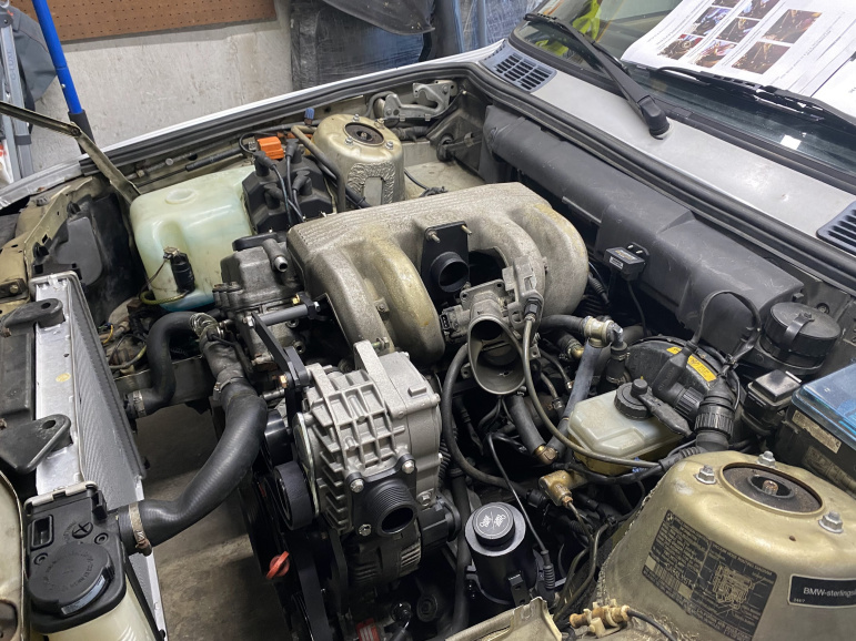

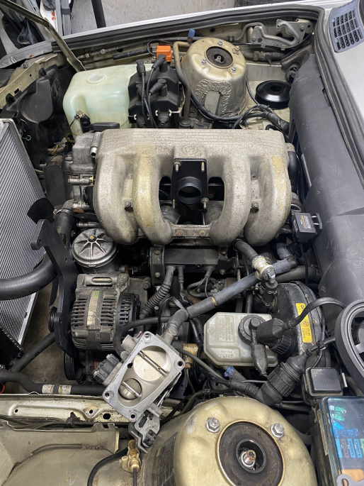

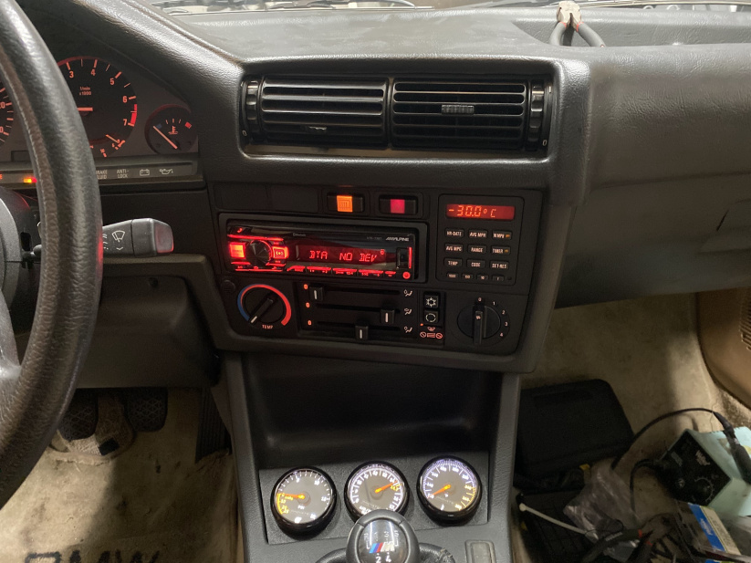

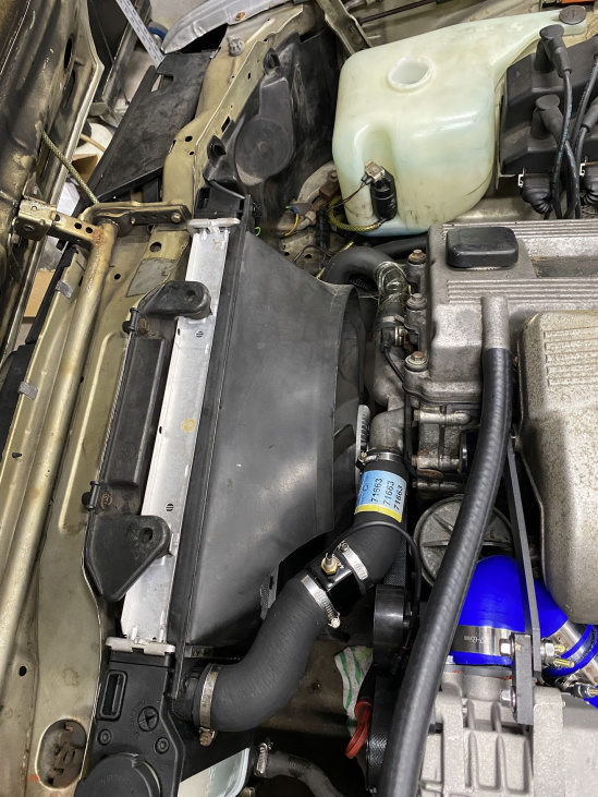

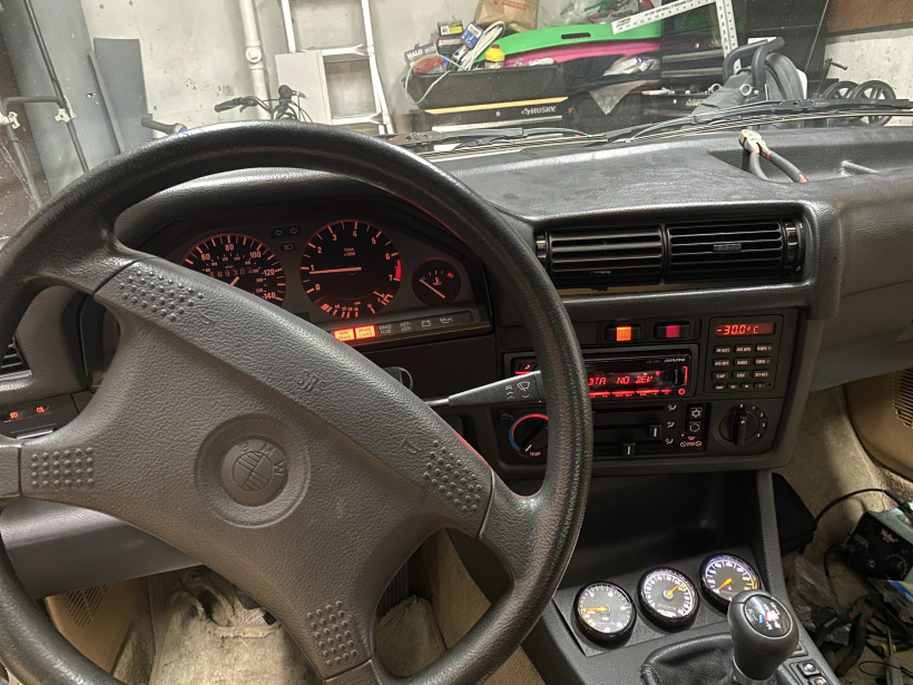

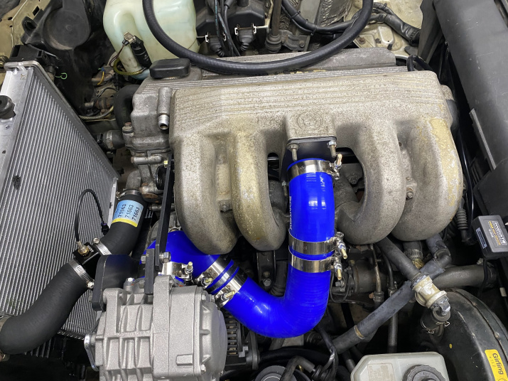

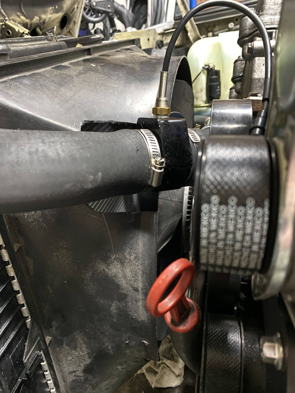

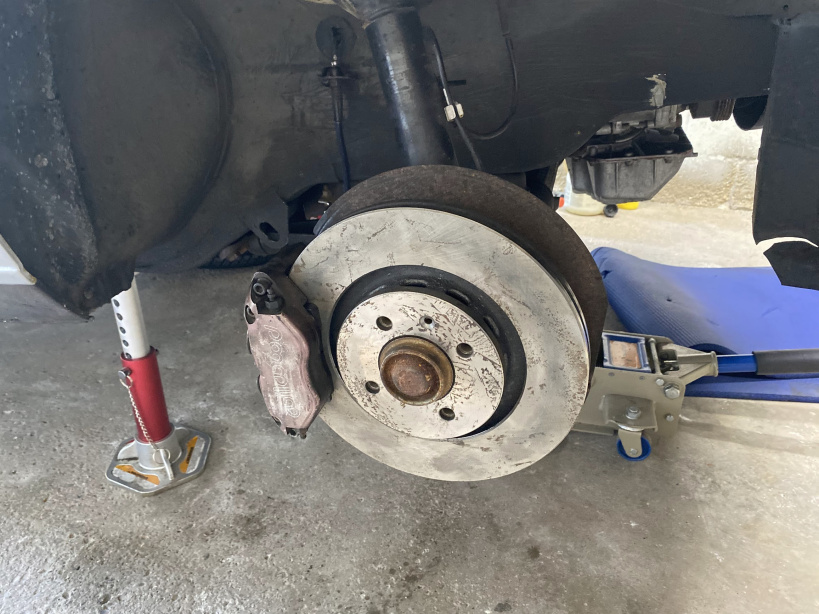

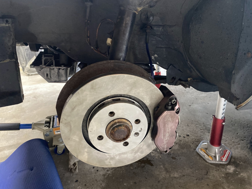

                          Hey guys, sorry meant to bump the thread a bit earlier. Over the past month I did quite a bit more work on it. Ultimately, I did the following:
                          * One of the rear calipers was stuck, so I had to replace that one and pads as well - they glazed over...
                          * The wideband + water temp + boost gauges were installed and are running alright, just need to hook up the water temp gauge after the supercharger plumbing is installed
                          * The front brakes I installed the 280mm rotors and wilwood calipers and everything seemed to be running well, but I did have to battle the dust shields a little bit - everything it TIGHT in there
                          * The engine got new 30lbs injectors and the updated ECU firmware
                          * The supercharger is physically mounted to the engine with belt and output plumbed to the intake
                          Pics follow :)
                          Cheers,
                          Artem

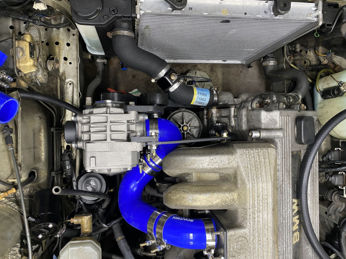

                          • Artem
                            • Oct 2006
                            • 154
                            More pics of the beginning of the supercharger install
