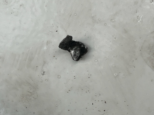

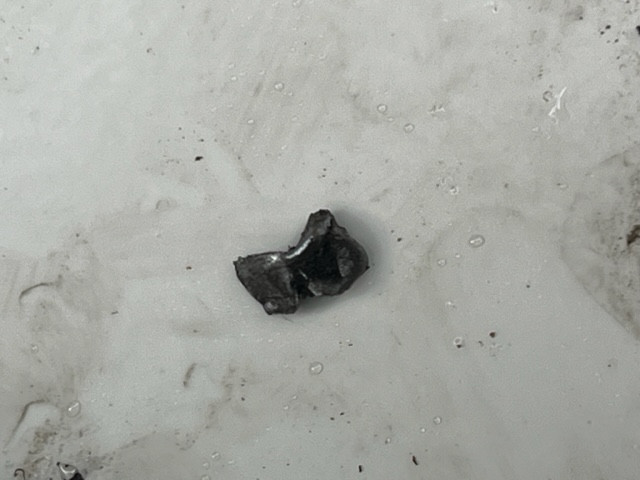

          #34
          So, here are photos of what I found in cylinder 4. Anyone have ideas what it is? Piece of valve? Valve keeper? It's only one piece, taken from two angles. Scale: about 1/4 inch.
          It's steel, picked up by magnet.Doesn't look like cylinder. Can't be piece of spark plug.
          Leak test tomorrow and then I'll pull intake cam and see if anything wonky is with cylinder 4 valves.
          THoughts welcome.

          • bmwman91
            • Oct 2004
            • 3134
            #35
            Hmm, well that is not ideal. I am trying to think of what ferrous items could get into the cylinder, and how. Maybe a valve seat came out of the head? There are some small steel sheet parts up around the lifters, like the valve keeper that you mentioned, but you would have to completely drop a valve all the way into the cylinder for any of it to get into there. That seems a bit unlikely. Maybe if a valve dropped part way it could have fallen through the guide into the intake port? That also seems sort of unlikely. But, at this point I think that pulling the head might be the best course of action.

              #36
              valve keeper

                      #40
                      how the hell would a random keeper get INTO the cylinder?
                      That's just... odd. Have you made any fresh enemies recently?
                      The other goofy thing is that chunks like that usually do 50- 100 revolutions
                      in the cylinder, munch hell out of the quench surfaces and piston crown, and then
                      get spat out or permanently embedded into something soft.
                      So why's it still in there?
                      All these questions and no answers...

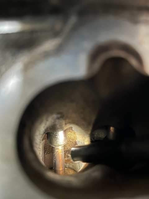

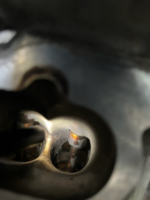

                          So -
                          1. I drove the car. Gently. Under load it felt exactly like a car running on 3 cylinders. No odd noises, clanks, or anything. I drove under 3k but a couple of times blipped up to 4500. About a mile of driving. Smooth and eager actually. Stupid car.
                          2. Removed the intake manifold. The intake valves appear to be in one piece and behaving correctly. By that I mean they open and close as engine rotates. I put a light in the cylinder and could see through the side of the head.
                          3. I toned out the fuel injectors. 2 and 4 are connected properly, 1 and 3 and connected properly.\
                          4. We checked compression on all 4 - 178-192 ish across all of them.
                          Didn't see anything wonky anywhere.
                          I then more closely inspected exhaust cam. From the top it feels like it's behaving as should. Cam followers going up and down. I haven't pulled exhaust manifold to see them visually. Really don't want to do that till I pull the head.
                          Intake valves on cylinder 4, my problem child:
                          Click image for larger version  Name:	IMG_0268.jpg Views:	0 Size:	32.6 KB ID:	10103858 Click image for larger version  Name:	IMG_0267.jpg Views:	0 Size:	41.4 KB ID:	10103859 Click image for larger version  Name:	IMG_0266.jpg Views:	0 Size:	39.0 KB ID:	10103860

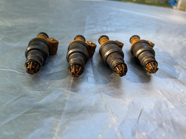

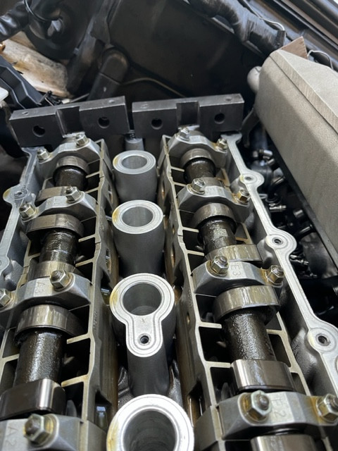

                                #45
                                Bolting intake back up. Checked timing and it's off. I don't think this is what is causing cyl 4 to not fire, but I'll fix it.
                                Also put back in my original fuel injectors. I swapped to mustang injectors (4 hole vs. 1 hole) when I was originally chasing the ticking noise.
