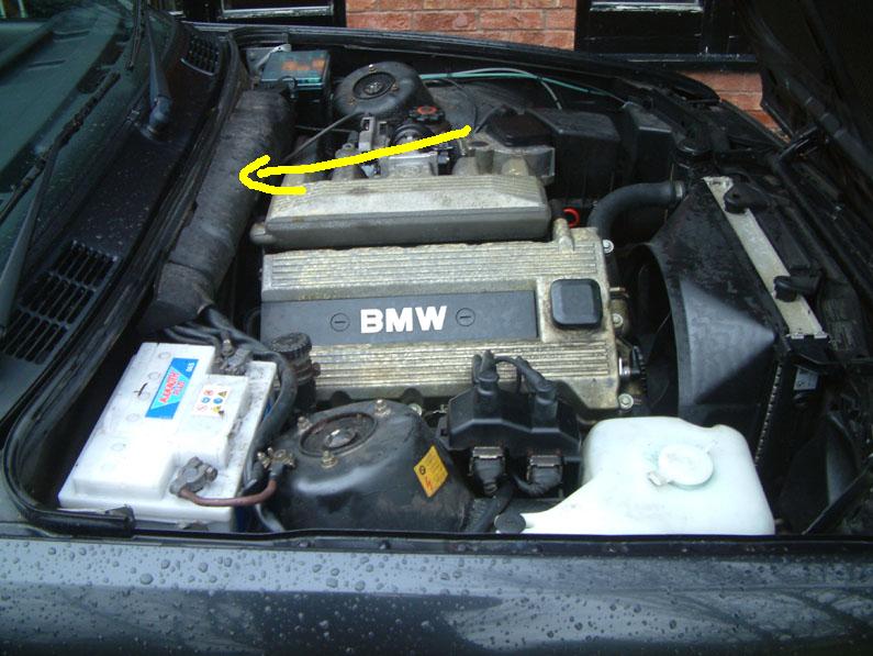

                          How is your intake boot, ripped?
