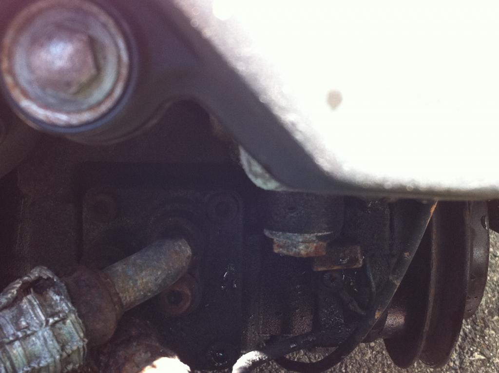

              • DrtyE30
                • 656
                Is that what your talking about, right above the a/c compressor and on the timing cover?

                • KenC
                  King of Kegstands
                  • 14396
                  No, thats the chain tensioner cap.
                  The block drain is under the headers.
