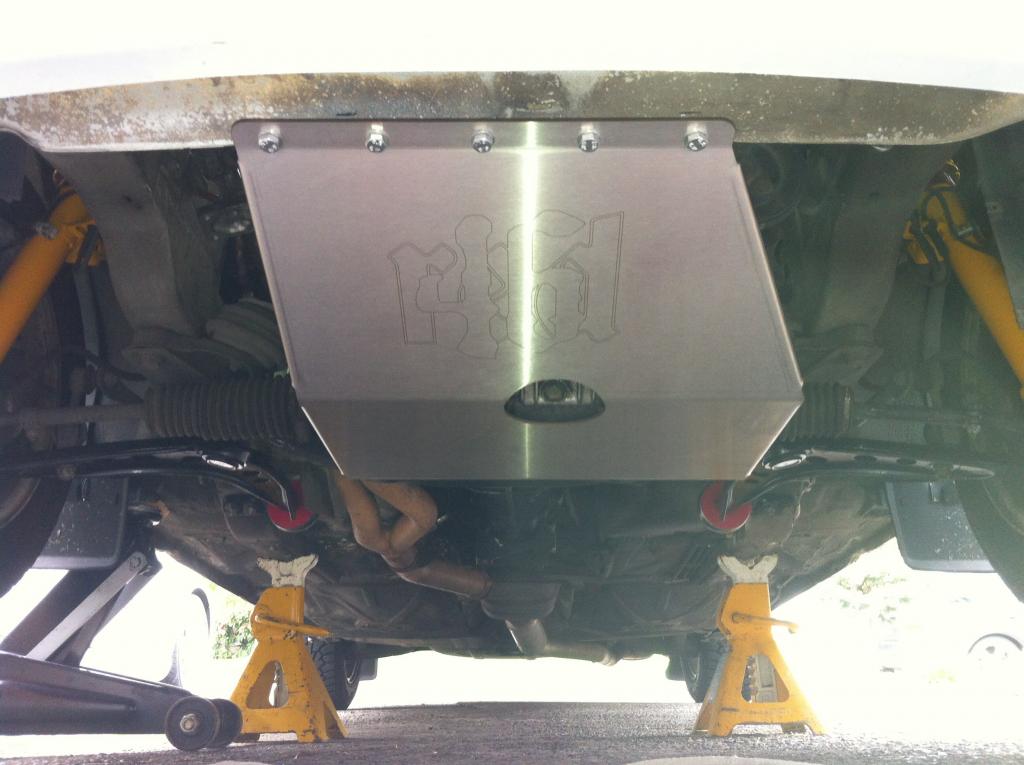

  • shameson
    replied
    Originally posted by estoguy
    I haven't bought one, but was thinking of this.
    http://www.red46.net/store/p6/Sump_Armor_-_BMW_e30.html
    I have a red46 plate under my car and I love it. Looks sleek and is very strong. Install is pretty easy too
