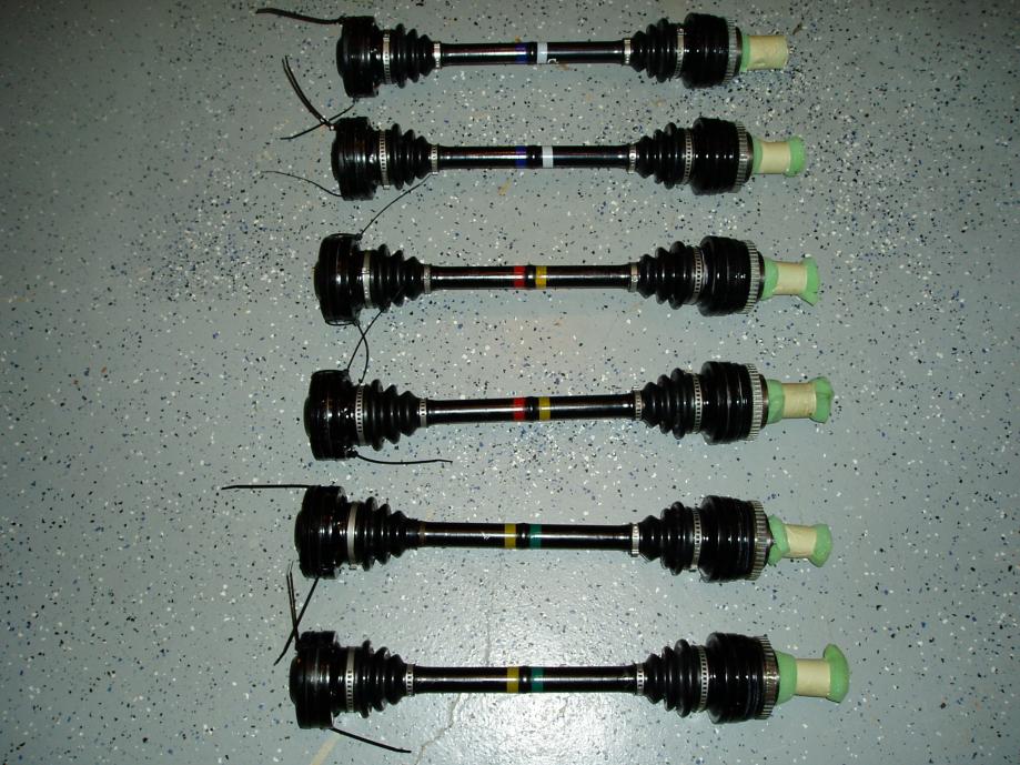

    A set of barry's rebuilt half-shafts
