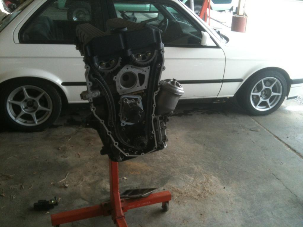

ID:	7141115First tease of the day :)

                      tranny is out!!! time to get the engine out!!!

                          Engine is out. New engine is ready to go in. Gotta clean up the firewall from my Z3 rack install and degrease the engine bay first. More pics tomorrow.

                                Today was a short day, but I did get the firewall patched up, revshift mounts in the car, and the M42/G240 pilot bearing into the M44 crank after a bunch of grease packing to pop the old one out.
