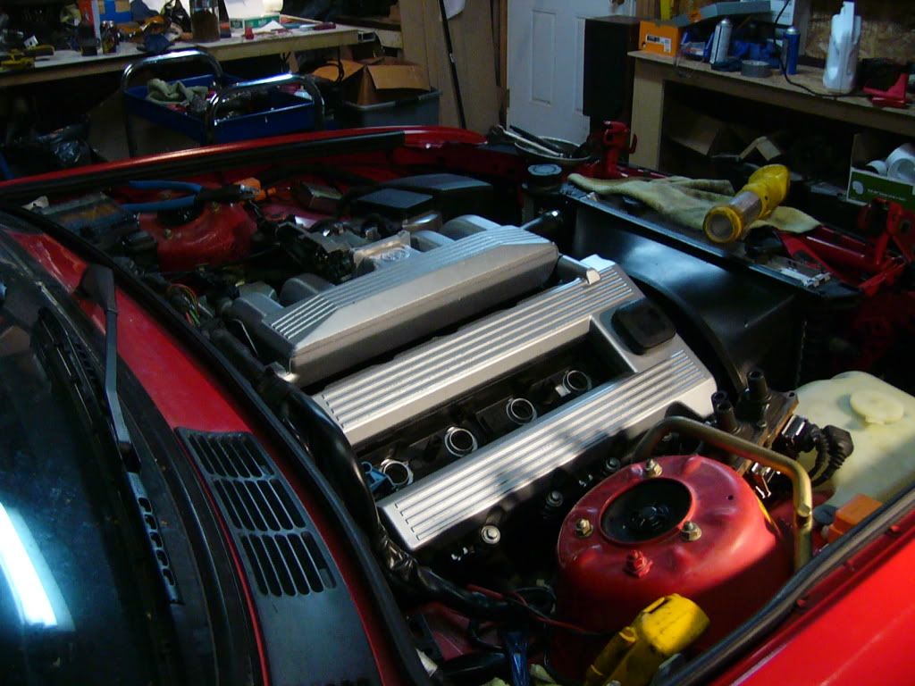

    OK, so what broke? That 3300RPM rattling noise from the last year that I had mentioned had disappeared, and of course was replaced with the sound of a loose timing chain. So, whatever was making the mystery noise finally gave up the ghost. On the bright side, I should be able to find the broken part now, since whatever it is, is now dead haha. I checked the obvious stuff; the oil level was A-OK, and the tensioner piston was still good. My bet had been on the idler sprocket, that I had replaced last May, blowing up, but I don't think that is the case.
    After my last rebuild, I swear that the tensioner piston was easier to install. It had the right stiffness, but the amount of compression I needed to put into it to install it seemed like less than I remembered. If you have replaced it you know what I mean...you insert it, and then you need to compress the spring maybe 1" in order to thread the cap. Well, after the last rebuild I only needed to compress it maybe 0.5" to get the threads engaged. I told myself that I was being paranoid & tried to forget about it.
    NOW, after [whatever] broke, the tensioner needs about 1" of compression, and something MOVES when I push it in. I am suspecting that the tensioner rail that the piston pushes on has broken, probably at its pivot point. Either the rail itself has gone south, or the pivot pin in the timing case has broken. When I opened the oil cap, I could see small flecks of aluminum in the oil (and on the dipstick). The chain was probably chewing off metal from around the thermostat housing casting in the head. I also don't like that, but at least the little bits will all eventually get caught in the filter. The motor has 220108 miles now, and that's a decent amount for an original motor...perhaps it is time to retire it.
    I last replaced all of the timing case components (guides, rails, chain, sprockets) in 2006, about 75000 miles ago. Given that I have driven the car pretty hard in that time, it is conceivable that the timing parts have worn out. Sheesh, time flies! I still think of the engine as having freshly replaced parts, but it really has been a long time! Anyway, now that I have had a good night's sleep, I am trying to decide on what to do. I really am sick of working on this damn car, and I want a solid, reliable car to do road trips with. In saying that, I sort of know that a 22 year old German car just isn't quite the right match haha. But still, I have driven an E30 for 12 years, and there just isn't a single newer car I can think of (or in my price range) that is an actual DRIVER'S car. So here are the options I am considering:
    - Tow the car to a German auto specialist to have them deal with [whatever] broke. It will be a little costly, but I just don't know if I can stand to lose another weekend working on the thing.
    - Suck it up & rip it apart myself. Cheaper, but I lose a weekend.
    - Buy a Metric Mechanic Sport M42. Much more costly, but at least I don't have to worry about engine problems again for a very long time. I am not sure if I would do the swap or just pay a shop to do it for me, for the same reason as above. I would probably shell out for a MM transmission and differential while I was at it, just to make sure that the whole drive train is SOLID.
    - Have a shop repair the engine, sell the car & get something new(er). The new Ford Focus gets better mileage, has the 4 doors that I sort of want, and a warranty. It lacks the soul of the E30, but I am really sick of WORRYING every time I take my car anywhere. This makes the least economic sense of course, but it would get me peace of mind, which is hard to put a price tag on.
    Something funky is also up with the clutch (I can feel / hear a popping as I release the clutch), so I would have that taken care of as well. What are you guys' thoughts? I love this car, but I think it is sort of an irrational response based on the fact that I have dumped thousands of dollars and hundreds of hours into this thing. I KNOW that a newer car is the answer to my road-tripping needs, but I keep thinking that I can make my 22 year old German car reliable. Is this textbook insanity? Does my car have me held captive, and I have developed Stockholm syndrome?

                              OK, having spent a bit of time in M42's, may I offer a suggestion?
                              We all know that the first sign of bad main bearings is low oil pressure, right? That motor is known for a walking crankshaft. I assume you have addressed this with a new design thrust bearing? If that crank is moving around, there is no way for the main bearings to offer proper resistance to oil flow, so pressure will drop as the oil splooshes past the bearings surface too easily...so if your crank is walking, you will lose oil pressure.
                              As the PRMs climb, the crank is less likely to walk AND the oil pump will put out more, thus the tensioner does its job better, right?
                              Pull the thing out enough to get the clutch disconnected from the transmision before you test it, the pressure of the trans and clutch springs will make it hard to move, but spinning it above 2500 RPM would do it for certain. Of the 3 M42 motors I have messed with, the last 2 had well over 1/8" end play. There is absolutely no way they were gonna live for long.
                              Your story made me think of this, are you 100% sure you have acceptable end play?
                              Good luck on it. The M42 would be gone from mine way before any of this crap, no way would I put up with that motor for 12 years, even though I think it is the prettiest of all stock E30 motors:
