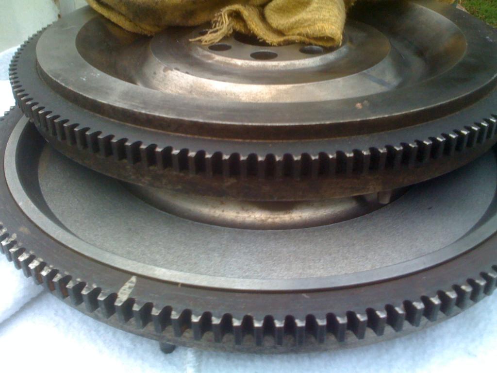

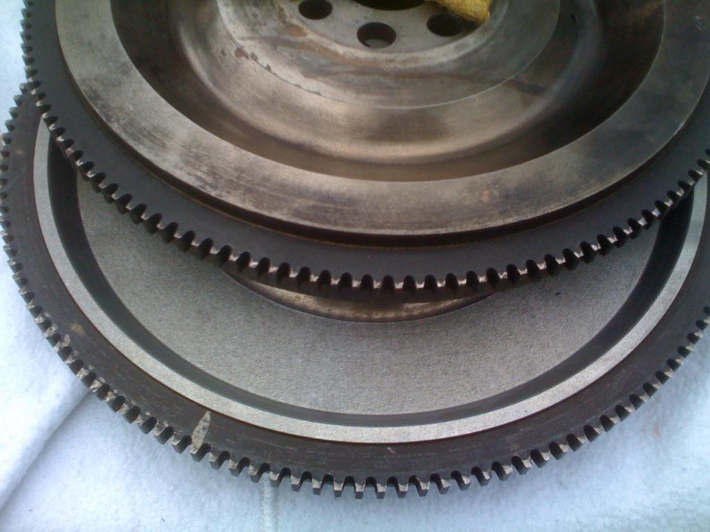

                  Posting my lightened to 13lbs m20 flywheel, cause I love it!
                  STOCK FLYWHEEL (for comparison)
                  Shaved!
                  Shaved lip comparison
                  Inner mass removed comparison
