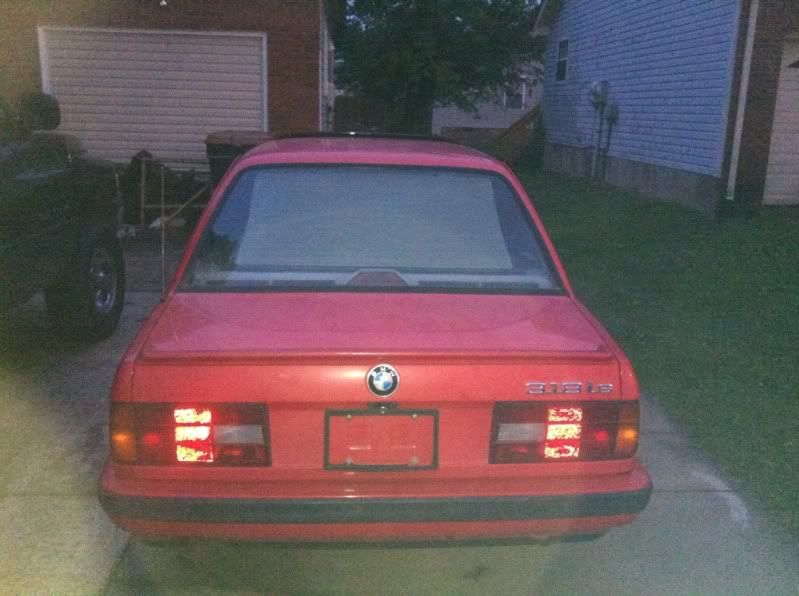

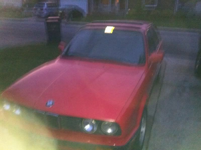

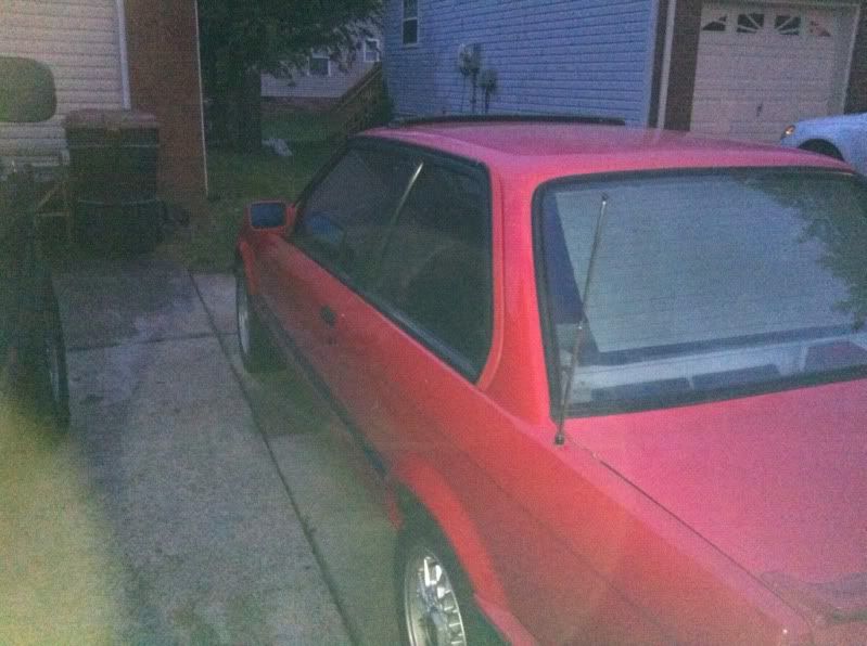

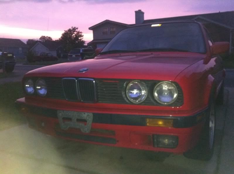

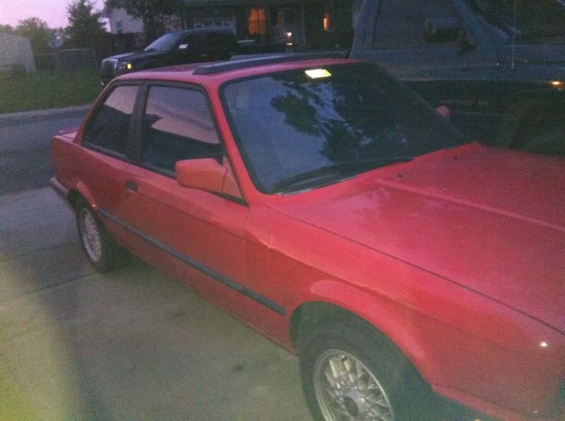

    so ive been in the e30 gang for a good minute this is my 4th one now..i have a 92 325i vert also had a 89 325ix and a 89 325i..now i got this baby for no lie 750 and the guy drove it to my house well delivered it cuz the water pump went on it and i already replaced that...its a 91 318is and i found the original bmw service book in the glove box..it does need a little work but minimal..but i think ill have to change the timing chain tensioner since its makes that diesel noise..but the thing is that it started doing it when i changed the oil today..and it did it at idle for the first 5 mins and i revd it up some and now it doesnt do it anymore while idling....so i think tomorrow im just giong to let it run for a while and see if its because the oil hasnt really gone through..also its been sitting in storage for the past 7 years and the oil and filter was pretty damn dirty, but enough with the talking here are the pics of the car
    and here is the video of the engine
    if u can help me out and let me know if it is the timing chain tensioner

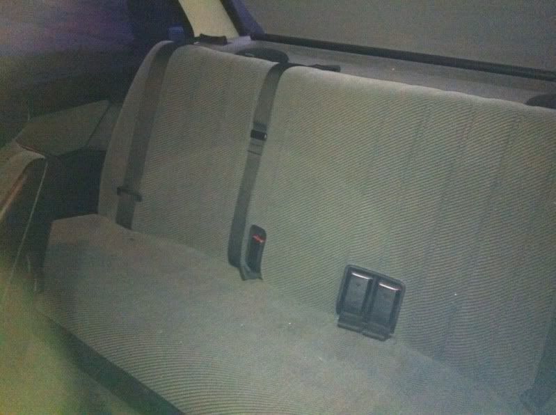

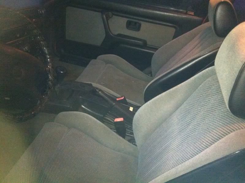

                Nice ride, there was I time when I would've killed for those cloth sport seats!

                        OP - sounds like you scored good with that car! I like the cloth interior better than the vinyl. My 318is has the vinyl seats and they do get toasty during the summer.

                          Haha yes they do. My very especially. Butt toasty

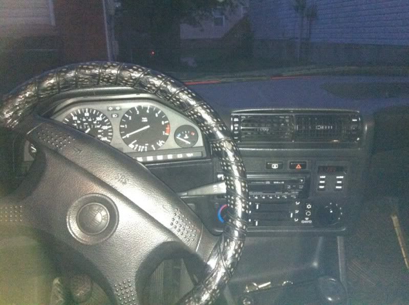

                              replace that steering wheel or just remove that wheel wrap its ugly. Overall I dig your e30.
