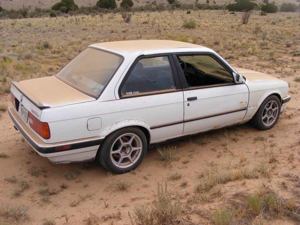

            race springs are pretty aggressive, but imo, great for spirited DD duty. It depends on what the roads are like around you.
            That said, I rallied my car w/ H&R Race, and it survived. i wouldn't suggest it though. ;)
            Another w/ different wheels for reference.
            But now my car has a more appropriate ride height.
