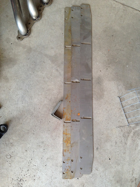

                    Another pic from the guy installing the kit. Just got word that he fired it up last night.
                    He still have a few things to hook up...make a downpipe (he is RHD)
                    A couple kits in production and about ready to ship.
                    Intercooler brackets pre powder coat. (one extra here...)
                    Manifolds all tacked together
                    Box full of hardware...silicone couplers, injectors, bpv, etc etc
                    Aluminum IC pipes in progress
                    [imghttps://lh5.googleusercontent.com/-9jdwT8HJvUU/UczaqQbnmYI/AAAAAAAAHJI/5auGCC4etk8/s640/IMAGE_133.jpeg]/img]
                    Everyone likes pictures so here are some more....IC pipes all coated with couples, etc
                    COP kit...
