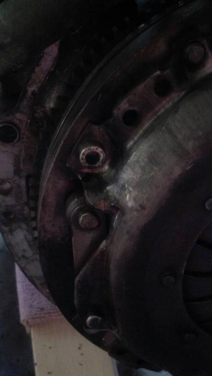

    Damnable pressure plate bolt!
    Any thoughts on how to get a rounded hex key bolt out? Click image for larger version

    a) grind tapers on a larger allen driver, pound it in, and remove the fastener. b) weld a nut on the head of the fastener and remove it.

      dremel larger straight notch across the head of bolt. Use a impact driver with a flat head blade to remove the bolt.
      a little heat never hurts either

        Vise grips or a bolt out. Something to grab the outside of the bolt basically. Most of the time, once they break loose, they will unscrew easily.

          a fan of dremmeling a slot - then taking it out with an impact driver. This technique has saved me numerous times..

            I swear by the vice grips...
            those bolts suck.
