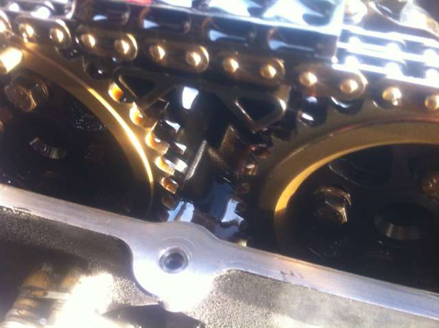

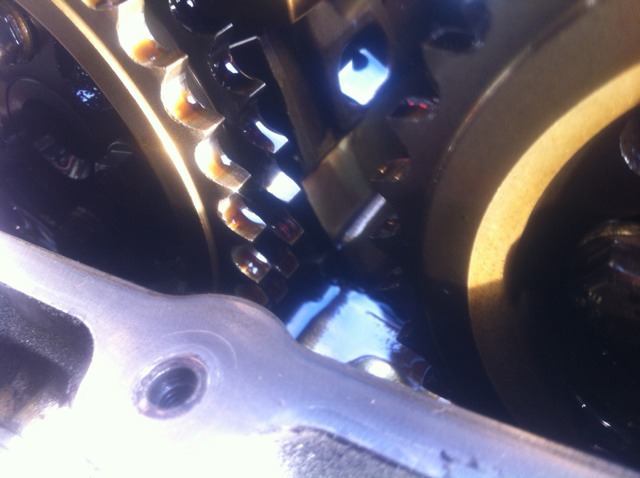

    I just checked under my valve cover.
    Along with 3 stripped bolts (causing a vacuum leak) I feel like my timing components need to be refreshed.
    RUFFLZ said that if this is too pointy and not squared off I will need a new timing chain, tensioner sprockets etc.
    If my valve cover thread is messed can I get those bolts in one size up?! Bc I'm planning on retouching up thread but not recoiling it.
    How sharp will this component will need to be before replacing the timing system?

    I'm not hearing much noise from the timing chain, none at all. I will run some test to see if I hear a rattle.
    But I was told if you feel the teeth and they are pointy, most likely you should replace the timing chain, along with everything else?
    Any one have knowledge on this? or another thread?

      You appear to be at the upper limits of wear on the cam gears at the very least. If I were you this would be a good time to drop the lower pan and have a root round for bits of plastic. If you see nothing there and are inclined to you might proceed to removing the upper chain cover to have a better look at your guides.
      As far as chain rattle the general rule is when you hear it something is being damaged and probably grinding bits of aluminum/plastic into your oil for your engine to eat. My $.02, if you have the funds, replace all of the timing components, if not just keep a close eye/ear on it.

        Dam those are some pointy ass gears.....I have some for sale 45 shipped....time to overhaul the timing bits
