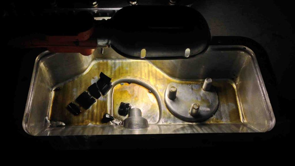

    How bad is it doc?
    I was doing my lower pan. And to my surprise i saw chunks of my timing guide.
    It was two weeks ago since i last had my lower pan off so my estimate would be somewhere along the guide broke and it's been hanging out in my pan.
    I'm deciding to either
    • replace the guides, chains, sprockets.
    • let it grenade while a refurb a new m42 on the side.
    • Or just put an m54 since this is my spare m42 car anyway.
    Any suggestions?
  • roguetoaster
    Biggus Tippus
    • 7830
    That looks like #7 below, if so you should be fine for quite a while.
    • jdirty
      • 346
      Good eye! I was trying to figure out which part it was.
      That buys me some time to decide then. Thanks!
      • bmwman91
        • Oct 2004
        • 3134
        You are probably fine. I wonder how it broke in the first place?

        • jdirty
          • 346
          That's very comforting to hear but i have no clue. lol
          Sustained r3vs past 5k...? Tensioner going bad..?
          • roguetoaster
            Biggus Tippus
            • 7830
            I think it breaks because it knows it's a totally pointless part. It's not as if the chain is going to jump off of the crank sprocket without killing the top end.
            Seriously, I think it breaks because it is the thinnest timing guide and thus is prone to "early" failure, as in 15 years or so.
            • bmwm42
              • 6300
              People run it without one I know buttchug does on his turbo car

              • TobyB
                • Oct 2011
                • 5286
                The ONLY thing to worry about is that when 7 gives up, 6 has started thinking about shedding
                its plastic lining, too, and that can make a mess (potential timing chain jump)
                At 180k, all of my timing guide parts were brittle and cracking- the $100 or so
                and the day spent changing them were well worth just the peace of mind, if nothing else.
