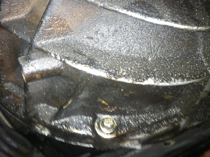

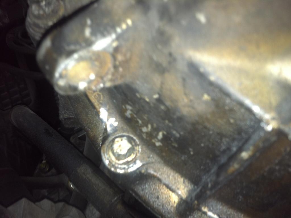

    so got the lower pan off, undid motor mounts, took the 2 long bolts out of the bell housing, jacked the motor up, got all the 10mm bolts out of the upper pan and then ran into these SOBs in the picture. they go from the bell housing into the back of the upper pan. They are regular bolt and are toruqe or something, so went to autozone and got there little kit, they dont seem to fit right at all just keep sliding off. these things wont budge for anything. tried spray the stuff on it to break up the grime but to no avail. how can i get these things off cuz now my e30 is just sitting on jack stands with just the 3 bolts stopping from changing my gasket.

    those are torx, and op it looks like you dun fuked em up by using the wrong socket and your rounded the heads off.
    Now you must find a metric 5 point socket that you can hammer over the rounded head, hope and pray for enough grip and crack those things loose.
    try 8mm for the smaller bolts

      that was with the torx socket from autozone

        are you sure its the right size?

          to clarify i did use the inverted torx and it didnt pop off. that was done from pushing down trying to turn, making no progess then taking it off and seeing it messed up. every bolt to this point had been pretty loose

            it fits snug on it. thats why its confusing

              Yea you have to be careful with those. Even if you use the right socket you have to make sure the socket stays on flush or it'll round. Like chug said get another slightly smaller socket and hammer it on. Take it off SLOWLY with a breaker bar

                Gotta love the E-torx heads. I usually use a 3/8" drive with 12" extension on those to make sure that I can keep the socket as aligned with the head as possible. Without the extension the ratchet hits the bellhousing and doesn't sit quite straight.
                As mentioned above, either hammer on a socket, or go to Sears and get a bolt extractor set. That should be able to bite into the remaining head enough to get it going. Before ANY of that, get a small can of PB Blaster and soak those suckers down.

                  Get one of those stripped bolt/nut socket remover if a smaller socket don't do the trick.
