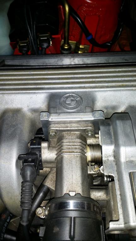

M42 high idle after throttle body heater delete

    Originally posted by Boris3
    or coolant temp sensor (blue one)? Turn the car off and check is plug tight? Maybe unplug and replug, and/or unplug, spray with contact cleaner let dry and replug and see.
    Yeah, I did that exact thing this morning. When I disassembled everything I sprayed all the connections with electronic connector cleaner and replugged everything back in. This is getting so frustrating

                              • jpatte
                                • Dec 2014
                                • 5
                                Heater Delete
                                Ok, here is my 2 cents.
                                When you installed the throttle body back onto the intake, you didn't install the heater plate. You really don't need the heater plate, but you do need the spacing it provides on the two lower bolts that are used to reinstall the throttle body. As your picture shows you didn't install the plate. The upper two nuts work great, the bolts have enough threads to tighten up the nut. But the lower two bolts are too long. It may seem that they tighten up, but they are actually bottom'ing out. So, your throttle body is being attached to the intake by only the two upper nuts. Allowing air to be suck into the intake. More air=high idle You can compare the pic that I uploaded from your first post. There is a notable difference with the heater plate.
                                Note: Heater plate does not have to be hooked up, just used as a spacer. I hope this helps.
