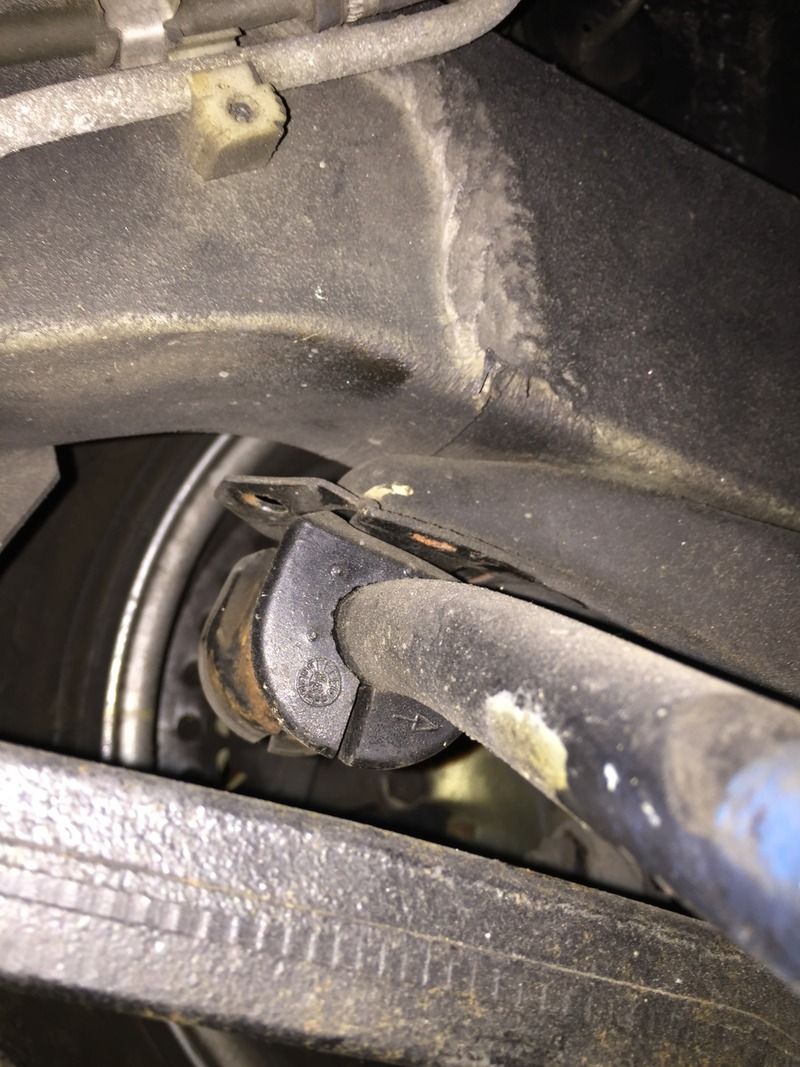

                      I just got back from the shop after spending all night working on this for the first time. Wow it feels good to get into it and actually see in person what i've been seeing in all these build threads and amazingly enough I stumbled my way through most of it unaided. I changed out the oil for Mobil 1 15w-50 full synthetic and a Mahle filter. Unfortunately, NAPA supplied me with a filter for God knows what, so for the temporary I put the old one back in and drove it 2 miles to my house where it'll sit til the new filter arrives. I started it up after changing the oil and I still have the same noise. I'm thinking my next course of action is going to be to pop the valve cover off, check the chain/gears and possibly replace the tensioner to see where that puts me. How do you feel about oil additives? I've never used them before and I think someone mentioned about using some, although I haven't the faintest idea where to begin on that. Right.
                      I did notice quite a bit more items on the car that were the "underwater part of the iceberg". I knew the car had some little things, I didn't anticipate a foglight being wire tied to the valence, the same solution used for the radiator shroud, a missing foglight gasket on one side and a missing cover and non working fog on the other. This next one is the most concerning, it looks as though the front sway bar isn't attached to the front subframe assembly at all, it's just flopping around in there??? There was a decent amount dirty grease built up on the bottom of the upper and lower oil pans and it looks like the lower pan was welded up after being scraped and eventually cracked from tagging. I took a bunch of pictures in the process and i'll be uploading them next, let me know if anything looks funny!
                      Thanks for your help thus far!

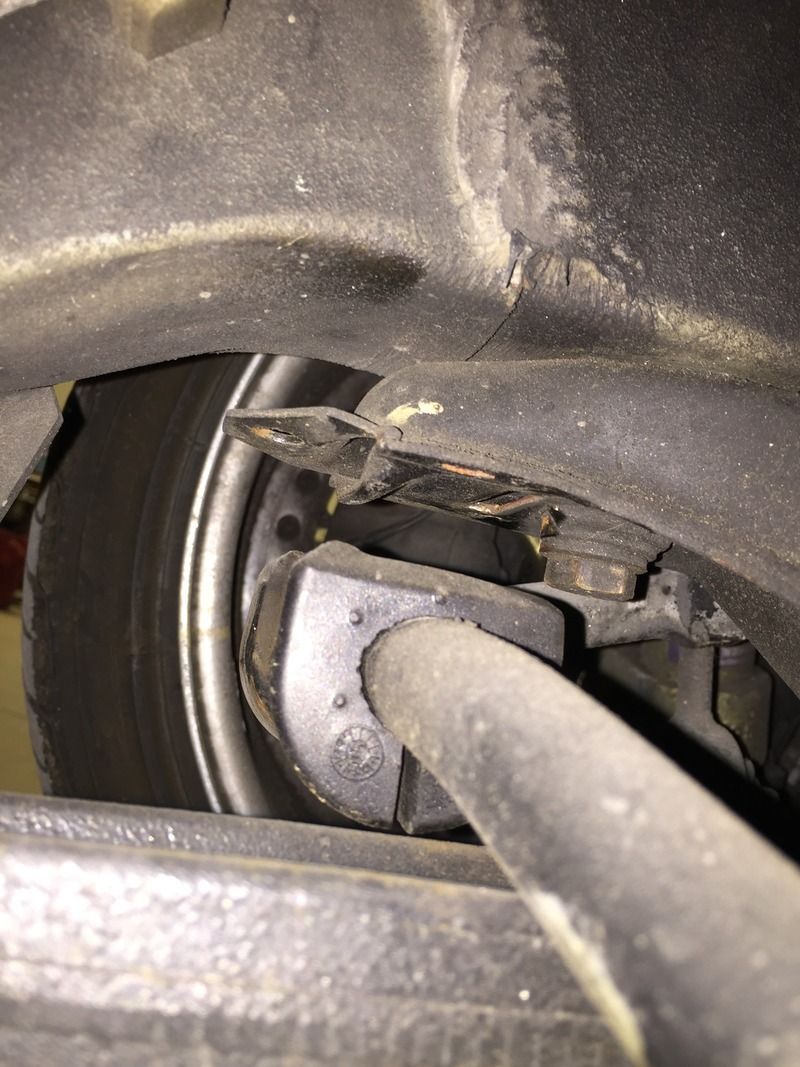

                          Okay, phone pics are awful, but awfully convenient as well.
                          The car actually has a very nice DIY Stainless Skid plate, I'll need to weld the nuts up a little better to the subframe, they aren't in such great shape as is.
                          The next is what I'm a bit confused about. Shouldn't this be attached? It's not on either side...
                          Also noticed this interesting substance inside the filler cap. Never saw this before...

                            That substance is mayo/pudding ... It's a mixture of oil and coolant but it also can be caused by condensation under the valve cover (had this issue with my e39). I would first check to make sure there's no leak in the head gasket. Do you notice any white smoke when it runs or any coolant leaking from below the manifold? Also now that you've changed oil check the dipstick to see if any milky oil is there again after running. If there's not chances are its just moisture due to too many short trips. Go ahead and check under the valve cover too since you're doing that anyway.

                              Not good
