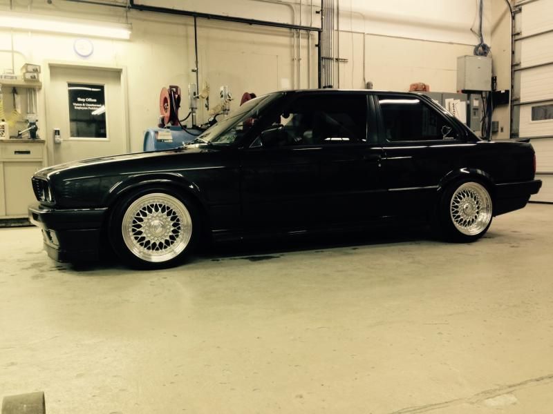

                            I love your wheels... I need to get me some neat wheels...

                              EDIT: Thanks Christian! They're hell to keep clean though, just picked up a Mothers Mini Powerball the other night to aid in this! LOL
