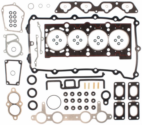

    My head gasket recently blew . I bought this head gasket set Click image for larger version
ID:	7243769 is there any special tools I need to get the head off or will a set of sockets do it.

          Hg probably popped due to either lack of maintenance or a bean dip previous hg job
          Op you will need a good set of 12 point sockets, some extensions and some Torx sockets to do the job properly. Follow the removal sequence of head bolts too.
