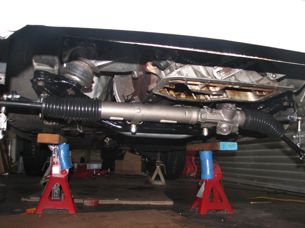

                  Z3 1.9 Rack
                  You made the right choice in racks as stated. “Twitchy” is a personal thing, I think it feels great and is better described as very precise and responsive.
                  If you ever drive an E30 with the E36 Z3 2.7 rack you won’t want to go back to the old E30 rack..night and day difference and reason I am doing this mod.
                  I have the E36 Z3 1.9 rack going in my E30 318is as we speak. Possible feeling called “Twitchiness” of the rack by some is helped by the use of E30 M3 offset FCABs. Right now it is temporarily fabbed up to check fit. and install Lemforder inner and outer tie rods.

                  You need the spacers mentioned (I mounted mine under the rack to space the rack up like the original) and the copper crush washers for the PS lines.
                  I used all new lines and reservoir from a E36? I sourced the washers and new mounting hardware from Bel-metric. I have a Red46 sump armor skid plate installed also, so I went with M10X100 bolts and used a thin nut to mount the rack. That leaves a small threaded portion to mount the skid plate to so I don’t have to remove the rack bolts to remove the skid plate in the future. Looks like I only have to grind away about 5mm of firewall for steering shaft clearance.

                      Nice install except the spacers should be above the rack to correct bump steer issues.
                        I think it all depends, some say above most say below. (maybe on whether you use E36 tie rods or E30 tie rods) I used E30 tie rods.
                        We shall see upon road test.
                        My original E30 Rack was set to the same height (Tie rod plane) in the subframe as my E36 rack with the spacers on the bottom.
