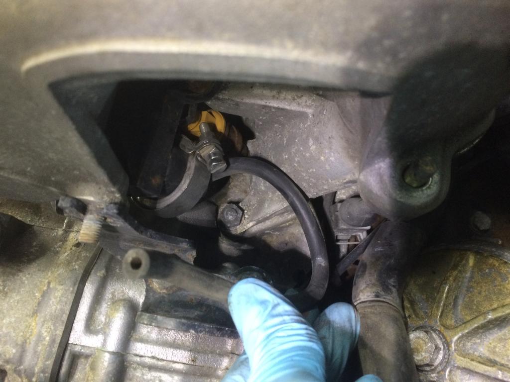

    I am wrapping up the "mess" mod on my 318 and while taking it apart I noticed the FPR small vacuum line was disconnected at the throttle body end.
    Weird thing is the car ran great prior to starting the work, only very slight idle hanging up, most people probably wouldn't notice it.
    I'll hopefully have her running in an hour, but just curious if anyone else has run their cars without this hose?
    Thanks!

    Sure. You run rich, until the ECU wises up, then you just get poorer
    transition fuel economy. And the ecu is always playing catch- up, as
    the fuel delivery rate's always changing...

      Thanks. I reconnected during assembly.

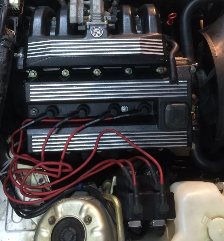

            I wish I had started a build thread (restoration thread), it's beyond satisfying to put a lot of work, parts, money, and have it run like it left the factory 25 years ago!
            I'm loving this little 4 banger!
            I have yet to route the plug wires, but pretty much all done.. For now.

              Soda blast stuff like the throttlebody for more pretties!
