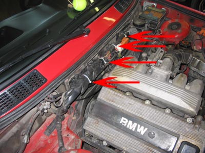

            No worries Mike. Anybody have a pic of the pump / ECU relay location. This is my first M42. The engine bay set up is different. I will check real oem for relay part # and cost. Thanks for the feedback. G.

              I'll take pic tomorrow for ya I have to check mine tomorrow

                  You have to remove the harness cover.
                  They are on the driver side. Same part #'s as an m20 (Replacement relay is part Part # 61368373700), usually orange, four prong. The white/silver five prong is your main relay for the ECU...

                    I might as well replace all 3 since I'm right there. Thanks for the feed back...... G.
