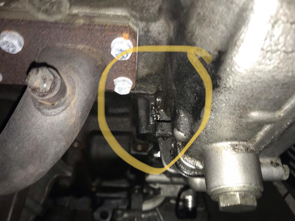

    Going through our new 318is Champcar and found a coolant leak in the lower front passenger side of the engine. What's the likely source of this leak?
  • uturn
    • Dec 2010
    • 1001
    Profile gasket.... not really the gasket itself but pitting of the cylinder head or lower timing case where the gasket sits.

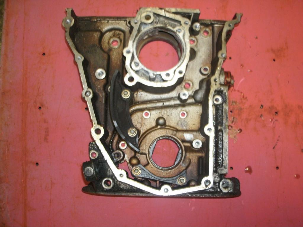

                    • OriginalSterm
                      • 34
                      Is this the correct later version?
                      • fresh_TD
                        • Aug 2013
                        • 2457
                        If the back side looks like this, yes.

                        • OriginalSterm
                          • 34
                          Yes it does. ~$125 on eBaY.
                          The rest of the existing components will work with this, except the gasket to the block, correct?
                          • fresh_TD
                            • Aug 2013
                            • 2457
                            You need the metal gasket for this case.
                            Late m42 timing case: 11141739699
                            Late lower timing case gasket (metal): 11141739868
