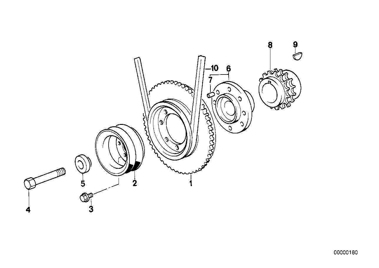

      Check the condition of the crank damper VERY closely. Push on it and look for any signs of the rubber separating from the metal shells. I had mine take a dump last month, and while it was a $500 part, it should be good for another 29 years and the car runs better than it has at any point in the last 5 years since it turns out that these things go out incrementally.
      Part #1 in this diagram?

        Yes, but it looks different in real life.
