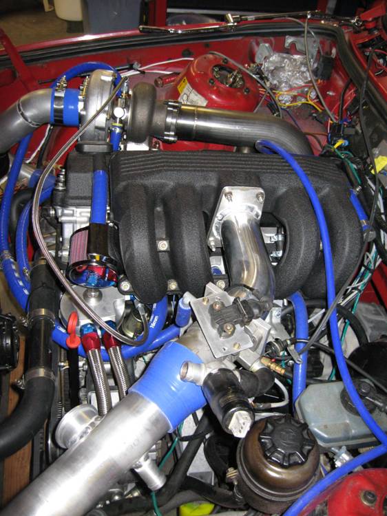

                The oil cooler in the picture of the E30 M42 turbo that Joe318is posted above is actually an aftermarket oil cooler (not pictured) but the oil filter cap helps to adapt the M42 to an oil cooler. Apparently the guy who was making those caps doesn't make them any longer but I believe Ireland Engineering is coming out with a similar cap.
                I co-own the M42 turbo car pictured above (it's a purpose built BMWCCA club racing car).
                My street car is an E30 S50 convertible. I am going to adapt my M20 oil cooler as an upcoming project. I haven't figured out all the details yet but I will either add AN fittings to the oil cooler or find a metric to AN adapter for the M20 oil lines. I heard that someone did it that way but it doesn't sound like a clean install.
