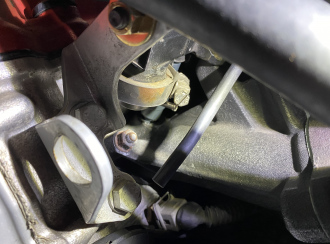

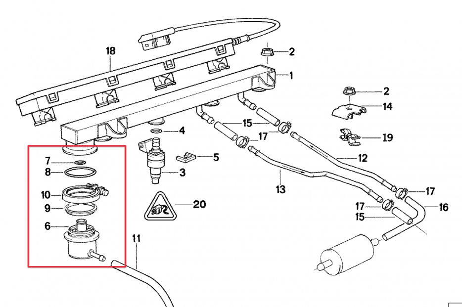

    Hi all, in an effort to chase down a "warm restart crank but no start" bug on my '91 318is, I have parts on the way to replace the Fuel Pressure Regulator (P/N: 0280160567).
    Would I be able to replace the FPR without removing the entire upper intake manifold + fuel rail?
Name:	CleanShot 2020-07-06 at 13.40.13@2x.png
    I see that the FPR is secured with a circular clamp with one screw on it, but not sure if I'd be able to get enough leverage to remove the FPR without taking out the entire fuel rail.

    The FPR is a simple device and easy to check. If there's fuel coming out of the vacuum line, it's done. If it hold vacuum, it's good.
    That aside, you should be able to get in there, but honestly the m42 manifold takes only minutes to remove so you have access to the rail. The hardest part is going to be getting the old one out in that position, they tend to stick quite well at this age.

      No, the FPR is going to be hard to remove as the o ring that seals it to the rail is likely going to stick. Additionally, the clamps fastener may be completely inaccessible. You should do all eight injector o rings too as you will at least be removing them from the lower manifold.

        ForcedFirebird Thanks for the tip, I'll check on that vacuum line. I'm also replacing crankshaft position sensor, fuel relays, O2 sensor while I'm at it based on reading other posts here.
        I'll attempt the direct FPR removal, and if that fails look into rest of manifold disassembly!

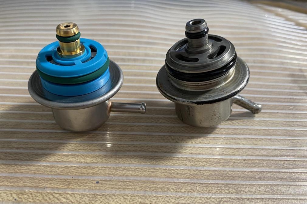

                            Received the new fuel pressure regulator (P/N 0280160567) and completed the install today.
                            Opting for the lazy method, I was able to swap the FPRs without disassembling the intake manifold & fuel rail:

                            Taking off the FPR with the fuel rail in place required a bit of wrestling. After removing the circular retaining clamp, I grabbed the extruding nipple part with vise-grip pliers to loosen the FPR. Then I took a flathead screwdriver and popped the FPR a few times with vertical force on its upper lip. Upon coming loose, about 1/4 cup of fuel proceeded to spill out of the fuel rail, so I had a bag ready to catch that below.
                            Old versus new FPR:
