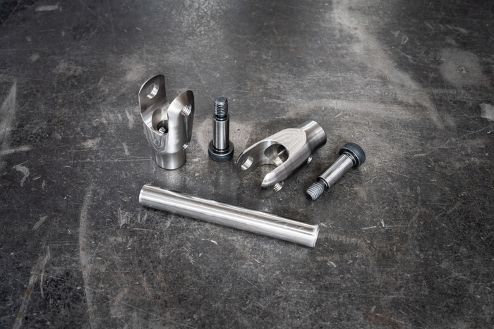

            fyi: this may now be an option.
            Weld-it-Yourself Custom DSSR Product Overview We make over 95 DSSRs for all kinds of OEM BMWs. However, sometimes, (especially with motor swaps), customers may require a custom, adjustable, twisted, or bent BMW selector rod. Well, now you can make it yourself! Simply take two machined ends and supplied rod, and

              Hell yeah, finally someone made DSSRs easier... I guess you have to have/know a welder.

                Agreed, having the kit ready for welding speeds things up.
                Next evolution of this is having a blueprint, readily available, that someone can take advantage of or send to a prodecer for manufacturing.
