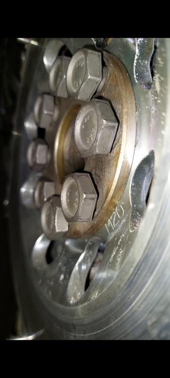

    • notporgu
      • Aug 2022
      • 32
      I currently have the transmission out and am installing the shim, and the previous bolts are not long enough with it plus the rhd flywheel. It may be that the bolts I bought are "automatic" but I was under the impression that they should be the same.
      This is them fully loose. Kinda sketch.
      I don't like reusing them but I have no choice really.
      As for the starter, it looks like it's just really finicky. It has a lot of play when it's loose and is sort of adjustable.
      I'll get everything back together and update again.

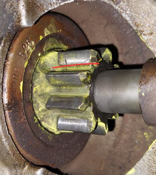

      • notporgu
        • Aug 2022
        • 32
        Update: everything is back together, after several attempts at adjusting the starter, no dice on getting it to stop grinding. As for the bolts and the shim, I had a tech look at it from the shop I work at, and he said he wouldn't trust that few threads, so I omitted the shim after all. Hours of work down the drain UGH. Anyway, I've narrowed it down to a few options. Here's the order in which I believe to be most to least likely
        1st, the battery is dead, causing the starter to operate improperly. I know for a fact the battery is crap, but I'm not 100% on it causing the starter issue, but I think I remember reading somewhere that the battery can cause grinding.
        2nd, the RHD flywheel is ever so slightly larger in diameter compared to the original flex plate. I lined up the flex plate and flywheel outside the car when I first installed it, and the teeth lined up 1 for 1. However, it's very possible that to total diameter of the RHD flywheel is maybe a millimeter or so larger than the original, causing the starter to over engage with the teeth. My thinking for this comes from this picture I took after painting the teeth and running the starter.
        Click image for larger version  Name:	Screenshot_20220819-140913_Gallery.jpg Views:	0 Size:	56.2 KB ID:	10065617
        You can see the paint is worn off down into about 5/6ths of the tooth, when it should be down only around 3/4th or 2/3rds.
        The third and final option I've considered (and please Lord let it not be this) is the trans I bought was in some sort of accident, and the bellhousing is bent ever so slightly, causing poor engagement.
        I'm going to start with the battery for now, since it needs replacing anyway. If it doesn't help I'm just going to run it for a week or two and hope the issue resolves itself, otherwise I'll have to park it for a few months since I'll be out of town and I need at least somewhat reliable transportation lol.
        Last edited by notporgu; 08-19-2022, 10:36 AM. Reason: rewording for clarification

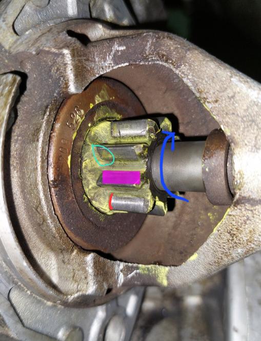

                    • notporgu
                      • Aug 2022
                      • 32
                      Update: heard back from RHD and they basically told me to check to make sure I have the locating dowels and the dust shield installed, which I do, and to verify my flex plate has 137 teeth, which it does. Not much more they could say really with the info I gave them, but after pouring over the media I've gathered, I think I may have found exactly what is grinding, if not why.
                      I took footage of starting way back when I first finished, which I've uploaded here. Using this I determined the direction the starter rotates to narrow down which side of teeth are actually getting worn, to better understand the picture I've already posted. Below I've drawn up what I believe is going on.
                      Ok maybe I'm going a little crazy but hear me out. So the blue arrow is the rotational direction as determined by the above video linked. The link highlight therfore indicates the faces of the teeth being engaged. If you look at red line, you can see that's right up against the curvature of the inside edge of the pinion gear. Basically where it stops becoming an actual gear. You can also see on the right edge of that same bottom tooth, the paint isn't fully stripped off! There's a distinctive line where it cuts off. I think what's happening here is the starter engages too far, smashes into the flywheel, and grinds up against the curved inside edge of the pinion gear. Your can see evidence of this in the cyan circle.
                      Now why is this happening? Not a dang clue. All I can say is it looks like it's a sixteenth of an inch or so too deep. Not sure how to fix that, or why it's happening. I'm going to respond to the email I got from RHD and give them what info I can, including this page. (Hello RHD support if you're reading this!)
                      If anyone else has ideas, still open to ideas.
                      • 82eye
                        • Jan 2009
                        • 2106
                        Originally posted by notporgu
                        U
                        did you source the trans swap all from the same vehicle or did you piece it together ? there is a difference in bell housing depth on some g260's. it changes by about 3/4 of an inch, as an outside guess it may be related to your issue.

                          • Panici
                            • Dec 2009
                            • 2570
                            The shim is different between automatic and manual. See the below picture from my manual swap. Automatic shim is thicker.
                            Shim the starter out a sixteenth of an inch?
