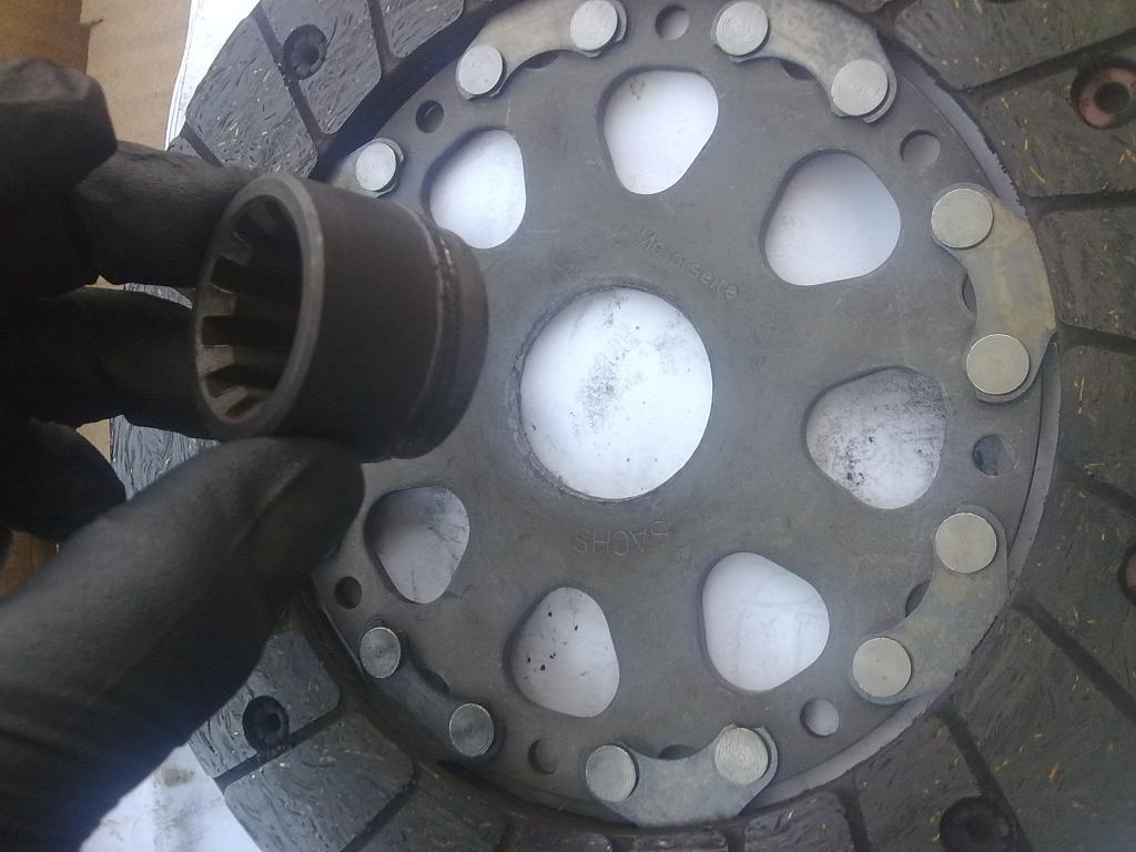

      • thebutcher37
        • 2877
        we are in the same boat
        I felt the same thing.... TWICE
        and both times it was this: (click on attached pic)
        I would say get someone to weld that shit in place, cause im sure your having the same problem as me... I would have welded mine but im in the process of an m20 SMFW conversion...
