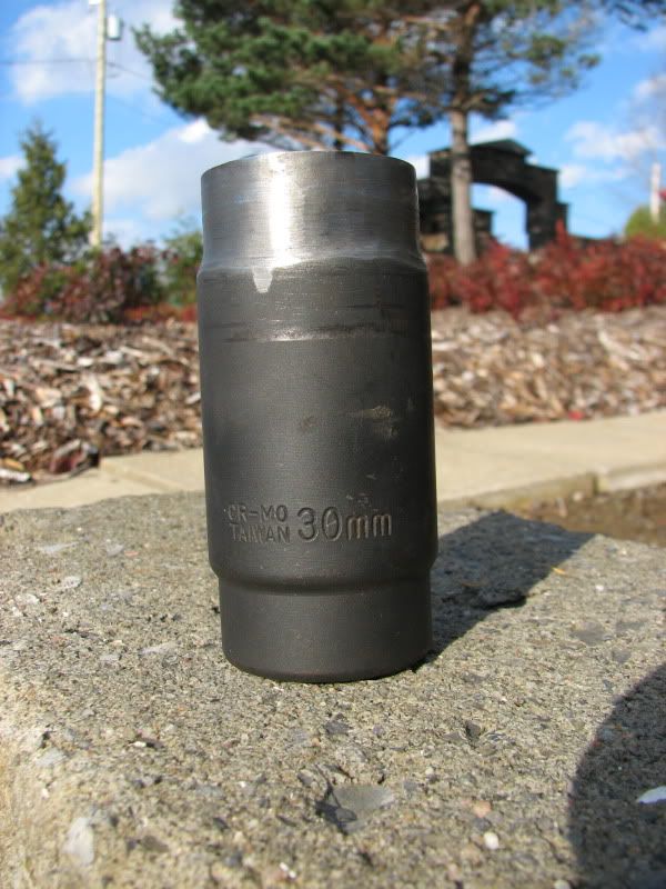

    Get a 30mm impact one and grind it on the OUTSIDE.
    Charley
    Edit: this is what mine looks like

      I went to harbor freight and picked up a whole set of metric, deep well, impact sockets. Took the 30 to a grinding wheel and ground it down some at the end. It fit in perfectly but couldnt get the thing to come loose. Maybe I was doing something wrong, but the socket fit on there no problem if that helps you.
