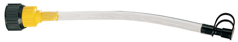

                  I've never used a hand pump to change diff or trans fluids. Use some vac hose on cap of the trans fluid bottle and hold it next to the transmission and squeeze. It takes some time but it was faster for me than deal with a shitty $5 pump that didn't want to have fluid flow.

                    This works like a charm, NO pumping & I don't spill a drop. Set the bottle in the engine compartment against the firewall
