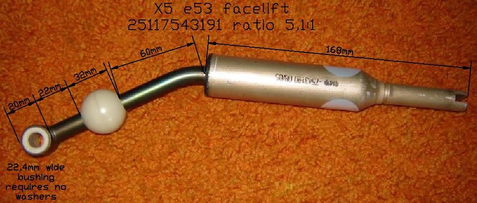

            Since you asked about other bushings... replace them all! Then replace your shift lever with an X5 3.0l one (25117543191). I had one in my E34 M5 and it was great.
