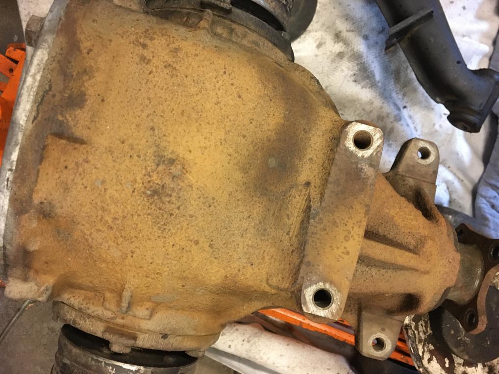

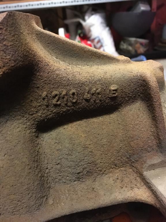

          Bringing this back up to ask a question -
          Our car is an '86 ES. We had the subframe off recently so I checked the tag, which checks out as a 2.93 LS. But I don't find any "S" stamp or casting on the case. Was that a painted stamp? I saw a reference to a cast-in S on the top.
          I need to refill this diff, so now I'm wondering if it's an LS or not....?
          Did I scrub it off when I degreased it?

            It was painted. Kinda like this:
            The E stands for factory reconditioned.

              It's unlikely it was ever off the car, and then I wire-brushed it.

                The easiest way to check if it's an LSD is to spin the rear wheels while it's off the ground. if they spin the same direction it's an LSD. If it spins opposite it's an open.

                    Yeah, just lift the rear end off the ground so that the wheels are in the air, release the ebrake and put the car in neutral, and spin one wheel manually, and look at the opposite wheel to see what it's doing.

                      If it's off the car, just try to spin the axles. If you can spin them opposite each other by hand, it's open. If you can't it's limited slip.

                        That's a casting mark. You want a stamped flat metal tag under one of the bolts.

                          The stamp3d tag will give you the ratio with an S indicating it's an LSD.
