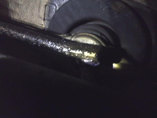

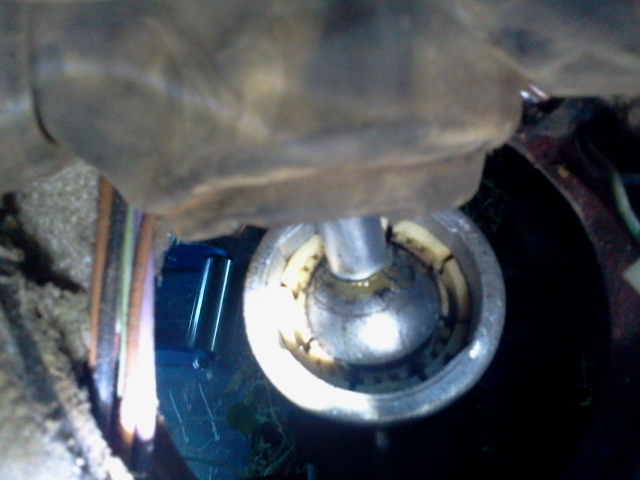

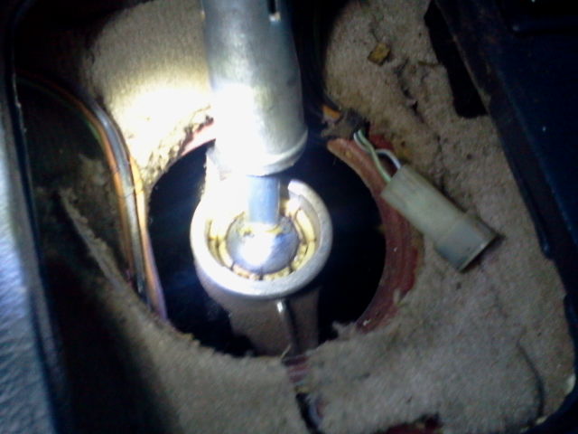

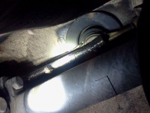

        Ok time for the update, I got some pics and the bushings do look bad but once the boot was off and I could see the action I am going to say it's prob the forks. I would much rather it be the shifter but oh well. Is there a thread on the best way to R&R the tranny? And do I need that gigantic shield that goes from my transmission to the rear diff? It seems I will have to cut my exhaust out to remove it?

                OP, I don't see anything out of the ordinary on your pictures. Like you stated, there is suppose to be an shield between driveshaft and exhaust. You also don't need to cut exhaust to remove anything. You could loosen the exhaust to help remove the trans but I've done it without removing exhaust.
                Sorry I can't be of any more help with your situation.

                    And like Poorboyz said, nothin looks out of the ordinary with your shifter, just a dirty selector rod :) I would jiggle the selector rod and stuff to see if there's any slop in the system

                          It looks like the selector rod is slightly bent in your pictures.
                          I would have someone operate the shifter while you watch from underneath to see if it's moving excessively or getting caught on something. As other have said, you might have worn out bushings. There are quite a few, and some of them will allow more slop in the shifter than others.
