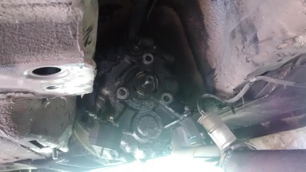

        They are all reverse torx. The starter bolts are E12, the center top is a E14 along with 3 side bolts, one on drivers side, one on pass side and other one is pass side towards top. Then there should be 4 E10 bolts at bottom of trans.
        Some pics of mine after I rebuilt it. Hopefully you can make out trans bolt location. Also, check out the part number on side of trans.

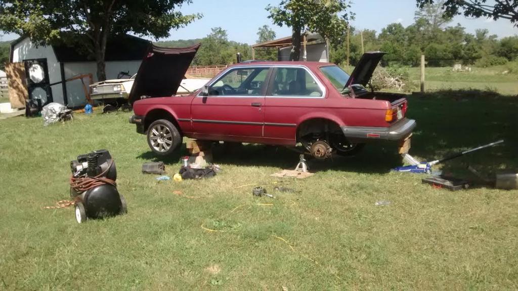

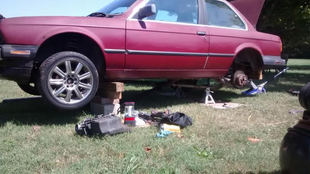

                          Here is where I'm at, have the driveshaft, exhaust (had to take it lose welded up right in the way), shifter is out, slave is hanging out of the way( still primed that way :) I also have every bolt lose I can get too on the bottom and sides, I am now on the starter and it has the nuts so the back one is trying to woop me but the wife just delivered the Rockstar you see on the roof so it's about to be ON! I didn't have another set of jack stands so I used solid 12" blocks with red stone bricks as a crush zone if something goes wrong they will start dusting. The 4x4 wood blocks are treated, I also have a piece of treated 3/4" plywood under the rear jack stands. I have crawled under less and seen others crawl under much less, and it may be overkill but I do not want a car on me lol, plus it sucks in the grass but it's better than gravel. Ok back to the job I will take some pics later.

                            Oh almost forgot I have a jack under the rear bumper too just in case lmbo. And that's the sons El Camino, we were supposed to put the engine in front of it in this weekend but Bimmer comes first, I am going through his big motor right now, he bent some valves in it so I'm going with a 383 stoker assembly I have in the shed and some vortec heads I ported a couple years ago. It was already at 350hp but this should put it in the 400-425 range, but it's kinda heavy, you guys know how it goes HP to LBS rules all.

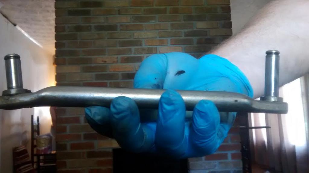

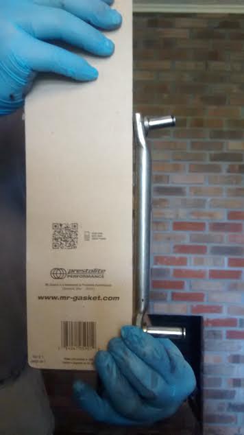

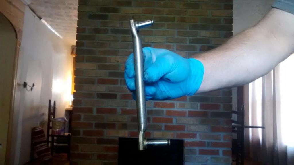

                                May Have Found Something
                                I got some pics of the shifter linkage and it looks pretty bent too me, would this keep it from going into 1st and second? I need a pretty strong answer if anyone has it because I need to keep chugging and pull the tranny if this wouldn't prevent the 1st and second shifts.
